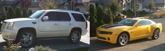

OT....how do you like that Camaro?

Camaro's great! Just hit 3500KM with no problems at all.
