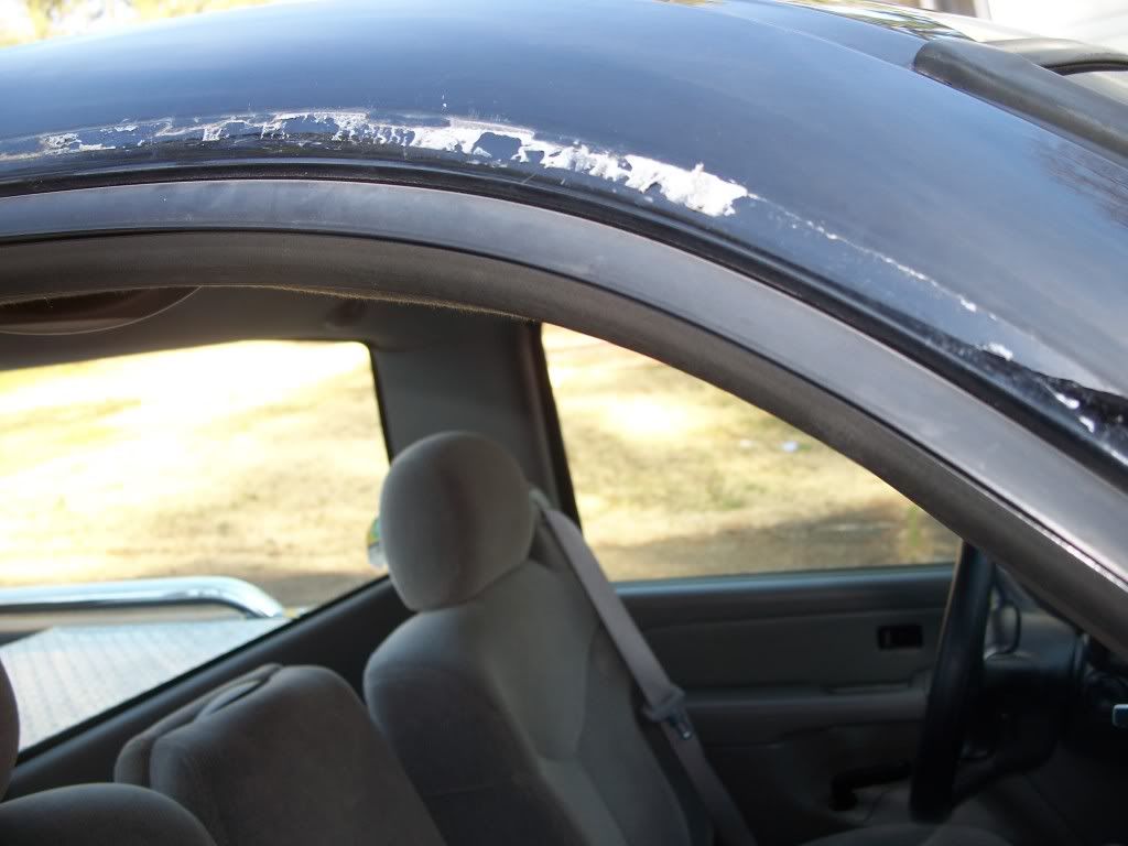

Ok passenger side is about as good as its going to get...not perfect, but its a truck not a sportscar(my brother's mustang :thumbs: ) so it doesnt need to be. Its at the point where the only person who would notice it would be me
Before:
During:
After:
It took about an hour and a half...Truck is still wet in the pic so it doesnt look great. The goo gone didnt help much, maybe i didnt put enough on :cool: Anyways, im pretty happy with it and ill do the drivers side tonight if i can

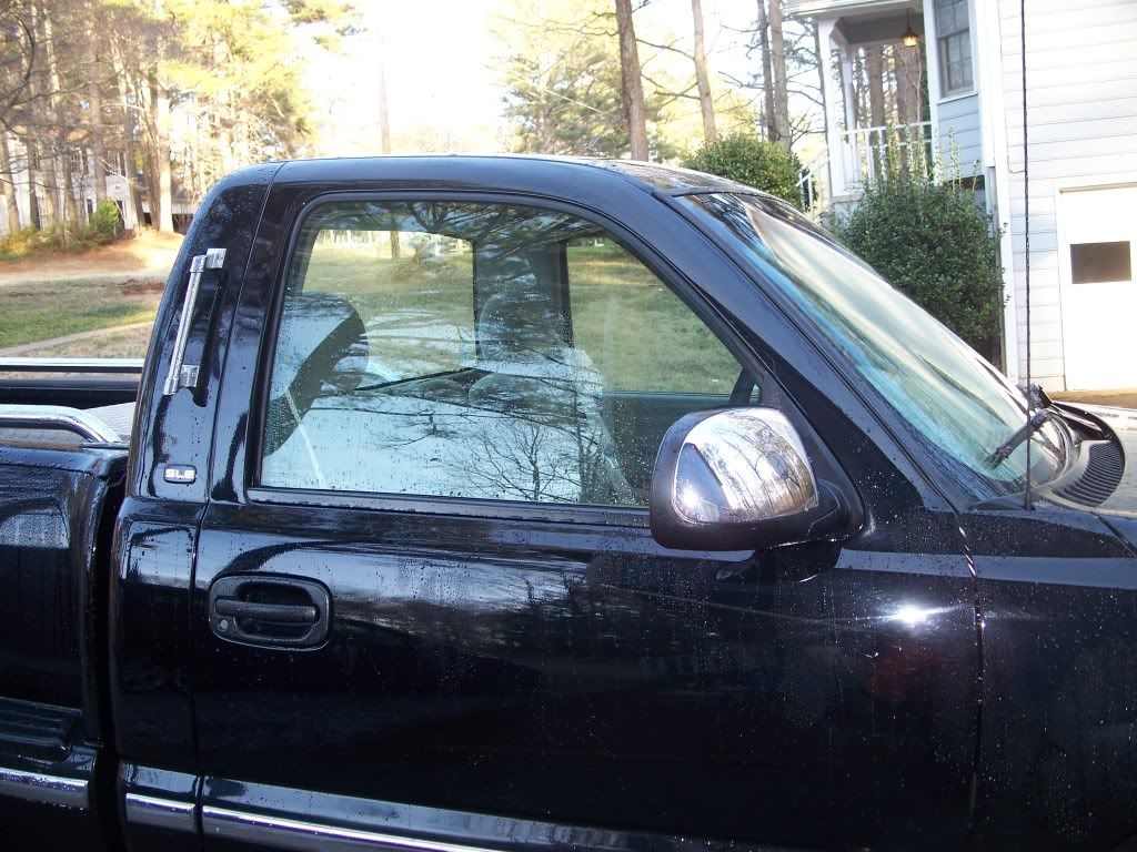

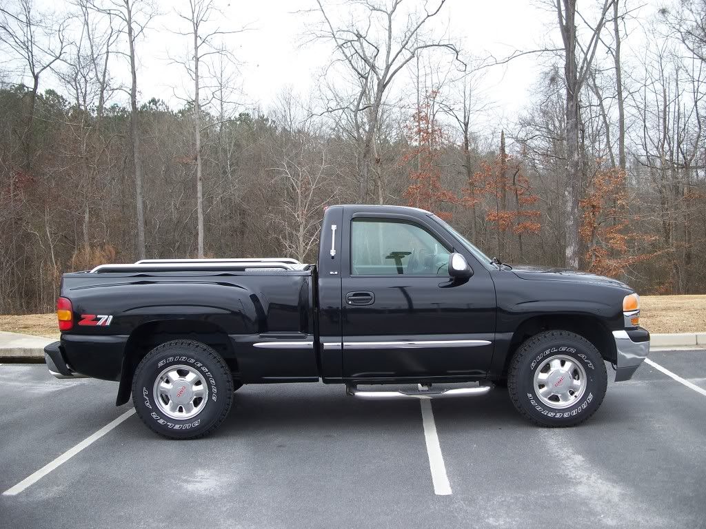

The previous owner was a handicapped guy so he had the chrome handles and chrome stepbars put on so he could get in...they are on both sides. I havent made up my mind if i like the handles or not but i figure if i remove them there will be holes and it would be more of a hassle to remove them than it would be to keep them on.
He also put in the stepbars, bedrails, and the bedbox which i like a lot, it sits just under the sides of the bed so it doesnt take away from the truck
