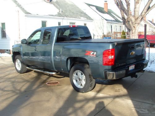

Caleb 6R Posted May 21, 2010 Share Posted May 21, 2010 So i'm a new owner of a 07 Chevorlet Silverado. Just wondering if there was a brake controller option in 07 for the enw body style and if i can just plug and play a factory GM one or do i have to get an aftermarket one installed? Thanks Caleb Link to comment Share on other sites More sharing options...
Pauldeere Posted May 21, 2010 Share Posted May 21, 2010 Check with etrailer.com. I installed a prodigy in my o5 Silverado in 15 minutes. The optional wireing hook up makes it a sinch. As you said plug one end into the fuse box under the dash the other end in the controler and your good to go...... Link to comment Share on other sites More sharing options...
MS3DALE Posted May 21, 2010 Share Posted May 21, 2010 So i'm a new owner of a 07 Chevorlet Silverado. Just wondering if there was a brake controller option in 07 for the enw body style and if i can just plug and play a factory GM one or do i have to get an aftermarket one installed? Thanks Caleb There was an optional factory brake controller option for the '07 GMT900's,However it was only available on the HD's,Not the 1/2-tons. It was not until the '08 model model-year that it was available across the board on all models (except those with the 4.3-V6) You cannot add the factory controller,There are too many parts needed,GM actually has a bulletin out telling dealers do not attempt to add it. Link to comment Share on other sites More sharing options...
Caleb 6R Posted May 22, 2010 Author Share Posted May 22, 2010 Damn, looks like I'll have to install an aftermarket one. Too bad the new GM ones seem to be the best right now. Link to comment Share on other sites More sharing options...
thearborbarber Posted May 22, 2010 Share Posted May 22, 2010 Damn, looks like I'll have to install an aftermarket one. Too bad the new GM ones seem to be the best right now. And you'll be more happy. From reading this board it seems there are some issues with the factory brake controller. Link to comment Share on other sites More sharing options...
