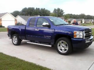

I have a 2010 Silverado that I just purchased and part of the deal was for the dealer to install the remote start. My salesman is now telling me that the factory remote start cannot be installed if it was not ordered originally and he wants to install an aftermarket one, but he didn't tell me what one. What RPO codes do I need for them to be able to install the factory one? I read on here that I need AP8, which I do have, but the window sticker says nothing about remote start installed or ready or capable. Is this the only code I need or do I need anything else?
