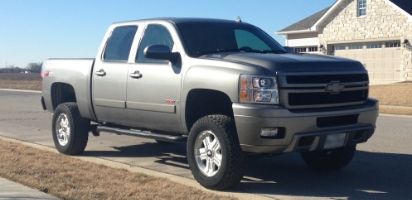

logan78 Posted October 18, 2010 Share Posted October 18, 2010 After 36,000 miles on my NBS 2007 Silverado my upper ball joints were shot!!! After inspecting the front end found that because of my 2.5 leveling lift the A arms were bottomming out the ball joints (too much angle). So out with the lift and try to find cheaper ball joints and A arms (sold as one piece for some reason) than GM (the local dealer wanted $350 a side). Everything I found was non-serviceable as I plan on trading the truck in a year or so didn't think I needed the lifetime gauranteed ones from Moog so I went with the cheaper 5 year warranty one from mevotech. When they arrived they had grease nipples, even though the book showed that they didn't. But now I don't like the look of the truck compared to what it was before. Might install a smaller front lift, 1.5" maybe. Link to comment Share on other sites More sharing options...
