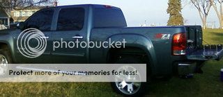

Man, the more I sit here the more mad I get. I just went down to the dealer's lot and none of the trucks there have a tail light assembly anywhere near as messed up as this thing is. It looks like the red part was glued to the back at the wrong angle making it have a weird arch at the bottom. It will not line up normally. To top it off while looking in it at night the signs of moisture are definately inside. A week from now it will be soaked again. I can't believe they lied about the new gaskets or washers.
Now what to do? If I go back tomorrow they are going to think I am a trouble customer. They are going to want to adjust this lens good enough to please me I am sure but is obviously way off.
I went out and took pictures I am so irritated.
Passenger side rear. Notice how it sits inside the metal fender?
Posted Image
This is the replaced drivers side. Keep in mind how wide the bumper is for perspective. Even when I force it in and clamp it down with the screw as far as it will go it still has that little swept out flare at the bottom.
Posted Image
