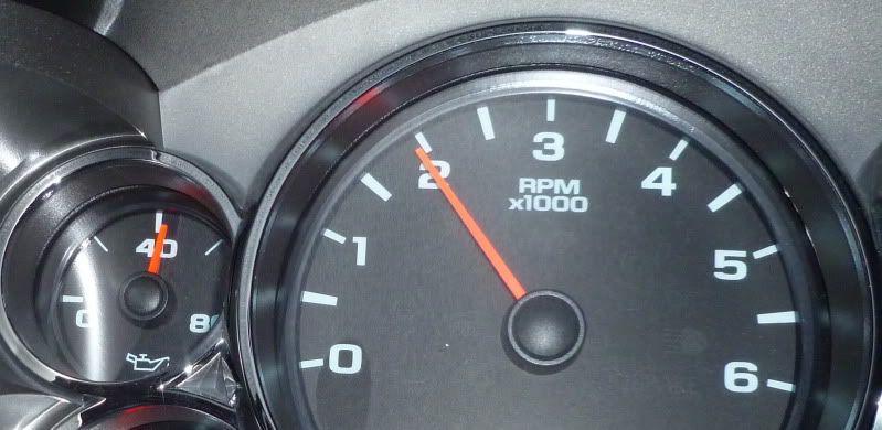

For starters, I'm concerned that my oil pressure drops so low at warm idle while in gear. It's between 1/4 scale and dead center which is I think is about 30 PSI:
However when racing it up a bit (1,500-2,000 RPM), it just crests 1/2 way, or dead center as you say which is probably a tad over 40 PSI:
In years of rebuilding motors, "higher" oil pressure was always seen as the better thing, not "lower". So if you had a filter that was yielding a "higher" oil pressure at idle, then to me, this was the better filter, no ?
As far as hydraulic lifters, and oil film barrier bearings (rod & crank bearings), you typically want "pressure", not "flow". In fact, as engines wear, higher "flow" (associated with increasing bearing clearances as engines wear) is seen as a "bad" thing since higher "flow" usually results in lower overall "pressures".

Ok, I sorta see where yer going here, but I think that your thinking might be backwards:
The 28-30 psi at hot idle your showing is just fine. Good rule of thumb is 10-12psi for every 1000 rpms. Mine reads exactly the same as yours.
