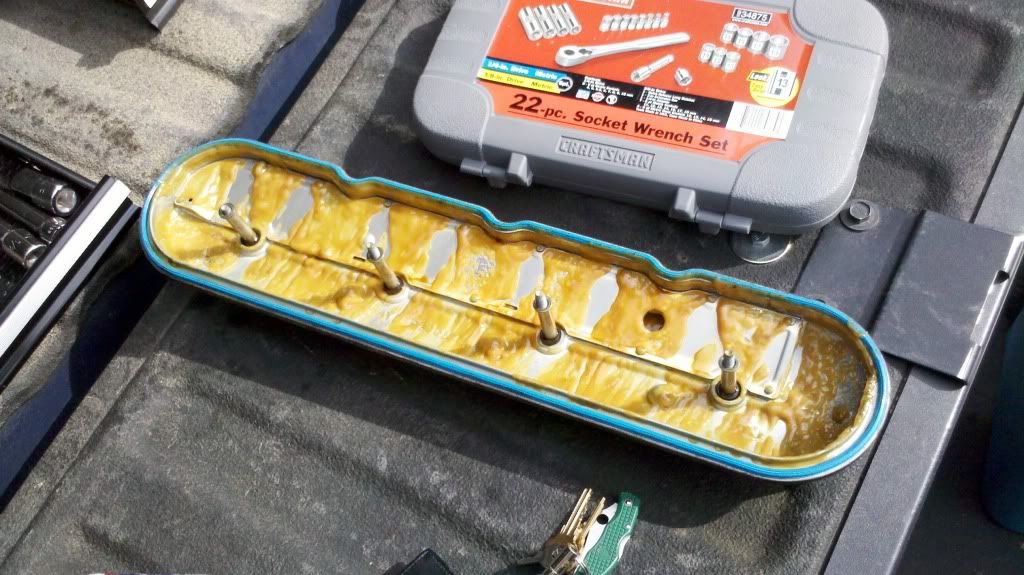

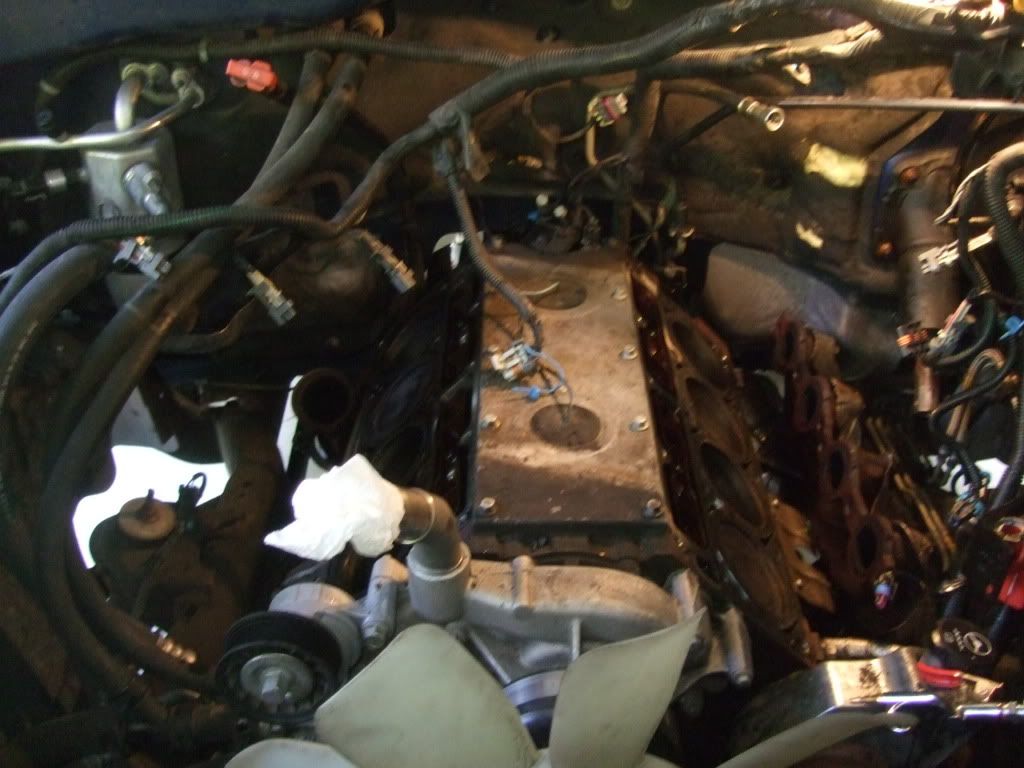

Swapped heads out on my '04 w/ 149k two weeks ago due to coolant loss into oil. Fairly certain one of them was cracked, based on finding sludge under only one valve cover and not in the motor itself. Head gasket looked fine. Did not have castech heads.
Worked 8:30am-7pm with two buddies, got the new heads on, rocker arms in, and exhaust back on. Put it the rest of the way back together (intake, generator bracket, etc) the next day in about four hours. Cost was $675 all in (tools, gaskets, heads, fluids, etc) using reman heads I picked up on ebay from someone who bought them for a built motor and then decided to go bigger for $160 shipped. New heads would have cost another $700-$800.
