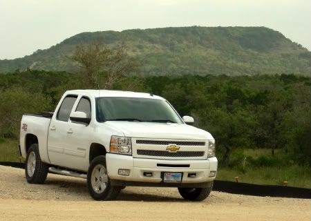

I have Yokohama geolanders(275/65-18) in a C load on my truck right now. I run 40 in the front and 38 in the rear.
Posted Image
