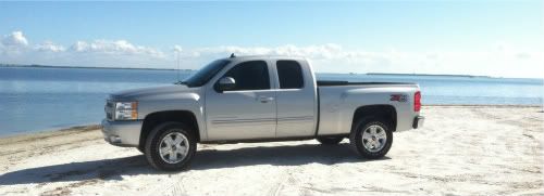

Sorry, I forgot I had this picture tied to my signature block. This was my 2010 rcsb 6 cylinder WT I had for two years. It was a mistake, so I upgraded to the 2012 Extended cab.
