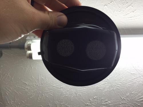

While changing bulbs and redoing my headlight caps to a better seal I decided to increase the housings availability to breathe. I'm one of the guys who's completely stock lights had mild condensation GM said was normal. I noticed TRS sells and recommends Gore-Tex patches so I picked up some goretex and drilled the high beam caps with two large holes and covered them with the patches. No moisture gets in, but the housings breathe better now. I figured the high beam caps would be easily fixed if there is an issue. I also put another set of holes up high on the side of the housing.
