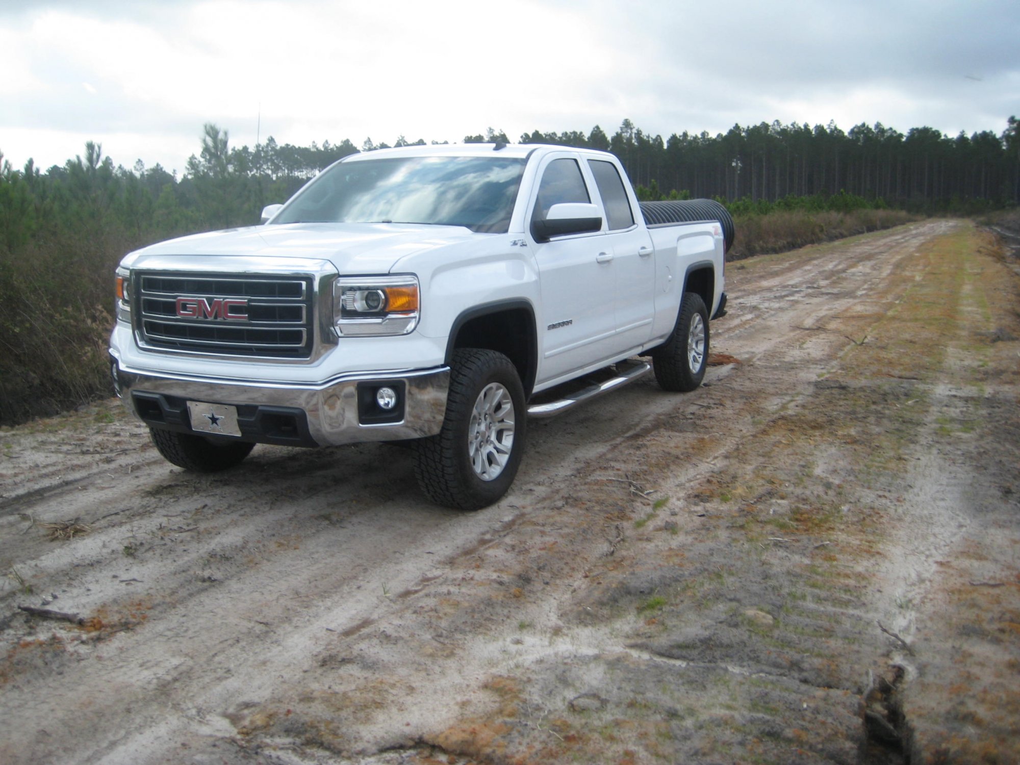

2014 Silvy Crew,_ IMG_0236.thumb.jpg.158049a838275d61ee391d15ed5e4030.jpgMotofab 2 1/2 up front and Ebay 1" block in rear, Falken wildpeaks 285/65/18 , when i first started looking at the lifts seemed 2' had more rake than i liked so I compensated, bought a 2 1/2" up front, alot of pics on the NEW trucks seem pretty level however, on mine once installed then the back sat 1/2' lower..WHY because a 3 yr old truck with a seasoned suspension. So answered issue with 1' rear lift, to do it over i would of went with 2 or 2.25 front lift

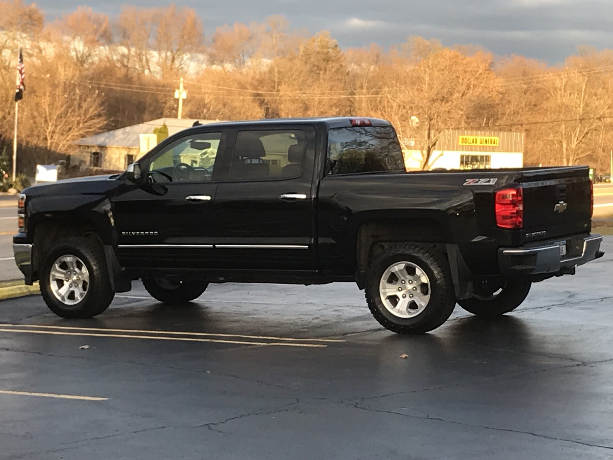

Well I ended up finishing the first part. It's a 2 inch RC level. The ride is a little rougher. I can feel the road a bit more.  There is about a 1 inch rake. I'm good with that.I don't get all the fuss with the kit. I installed both sides in 20 min not including jacking and removing the tires. All I did was jack up the entire front end so both tires were off the ground. Remove top nut on sway bar. Remove both strut bolts. Use a pry bar and push down on the upper arm. Just slid the puck in with some effort and that was it. No removing ball joints ect... I think I'm going with 275/65r18 Falken Wildpeaks.
