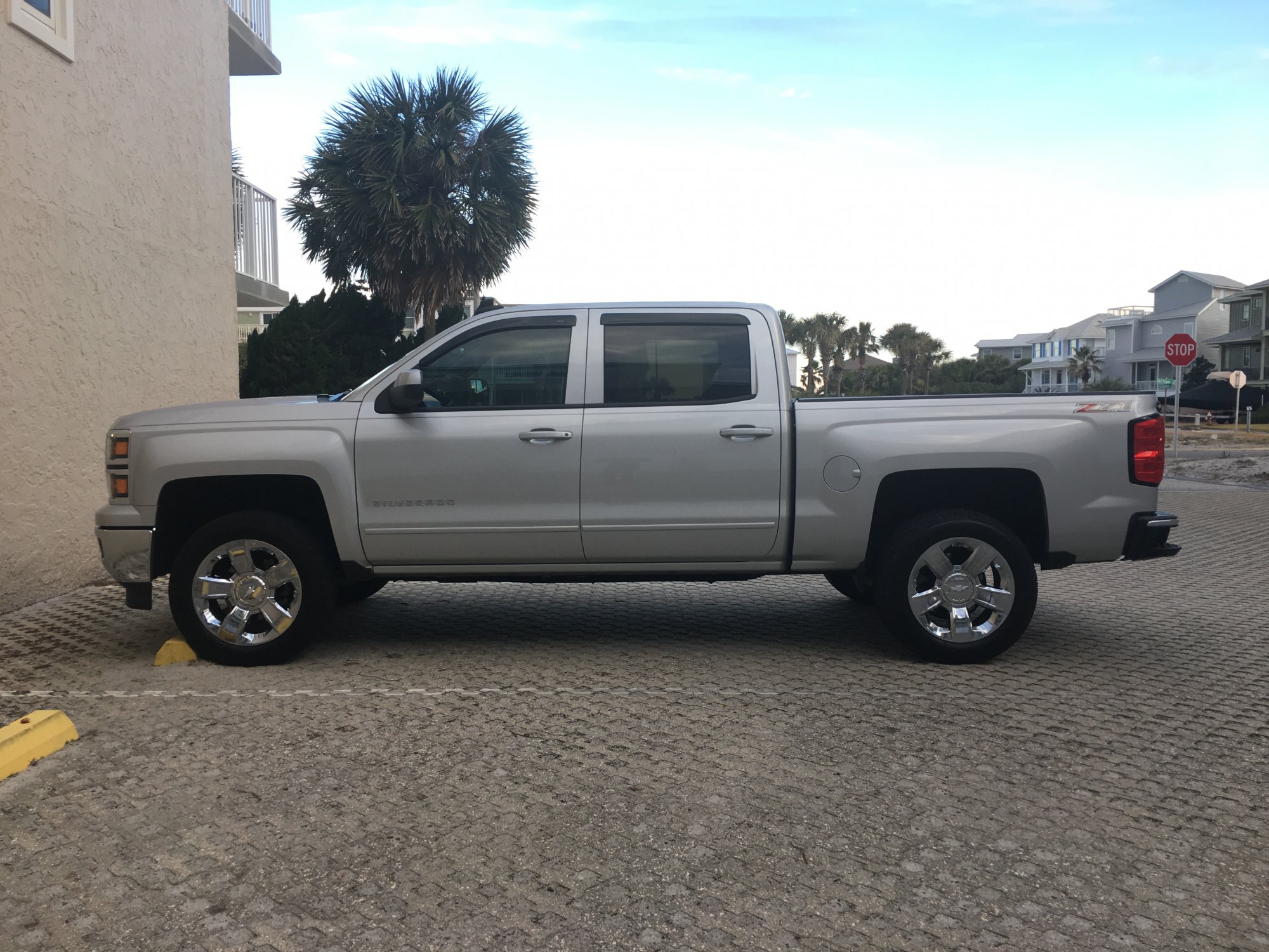

I was very hesitant and pretty skeptical, but finally installed Billy 5100s all around on top setting in front along with the ReadyLift rear 2.25 blocks and had aligned. I immediately notice the difference visually from about 30 yards away and is exactly what I hoped for; looks good and noticeable increase in wheel well space. Fitting slightly bigger AT tires shouldnt be a problem. I measured but pretty roughly as I wasn't too concerned about the fractions. I got 2" min. up front and obviously a solid inch in back. 1" of rake left. Wouldn't of minded a little more rake either. You can also feel the height difference sitting in the truck. I've owned a couple 2500s, one of which was lifted on 35s so I'm used to the height difference. I do believe I'll need to adjust the headlights down just to be safe. Haven't been flashed yet but can tell they're pointing slightly higher.
Driving is where this leveling setup really impressed me.  My round trip commute is 80 miles and includes roads of every type from highway to gravel.  I'd read all the reviews about a much firmer ride and feeling more of the small stuff in the road. You can feel a little more in the road, maybe, but not at all in a bad way.  To me It really feels really planted and just right.  Better grip, less bouncy at the same time.  Body roll is almost eliminated around bends with speeds in the low-mid range, still noticeable at higher speeds but improved nonetheless. Obviously it doesn't nose dive quite as bad during the quicker stops either.
My biggest fear was driveline caused vibrations due to the 3 degree rear block taper. Cross my fingers I haven't felt anything yet. Would still like to get on a much smoother highway to be absolutely sure though and stop worrying about it.
I do tow a 3 place but very light snowmobile trailer at the max; hoping it doesn't squat much if it all.

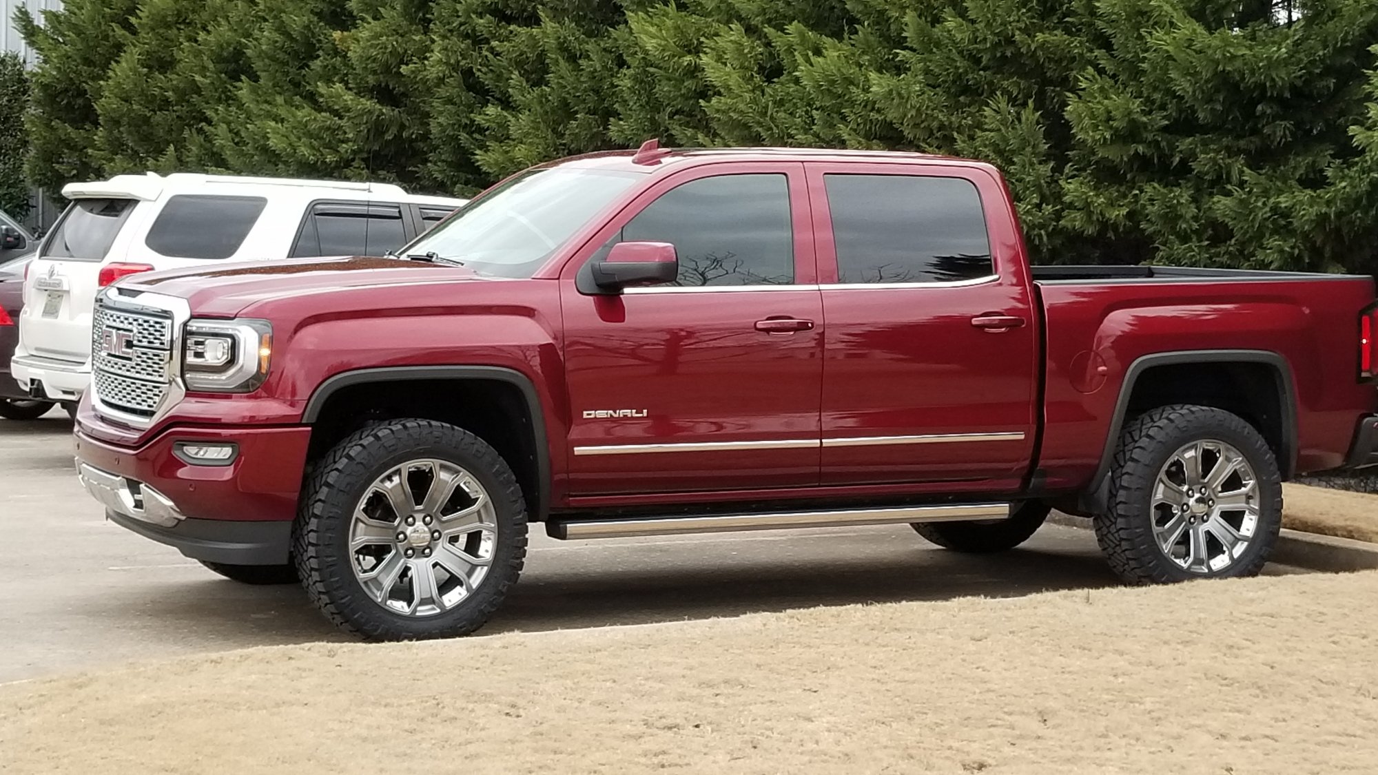

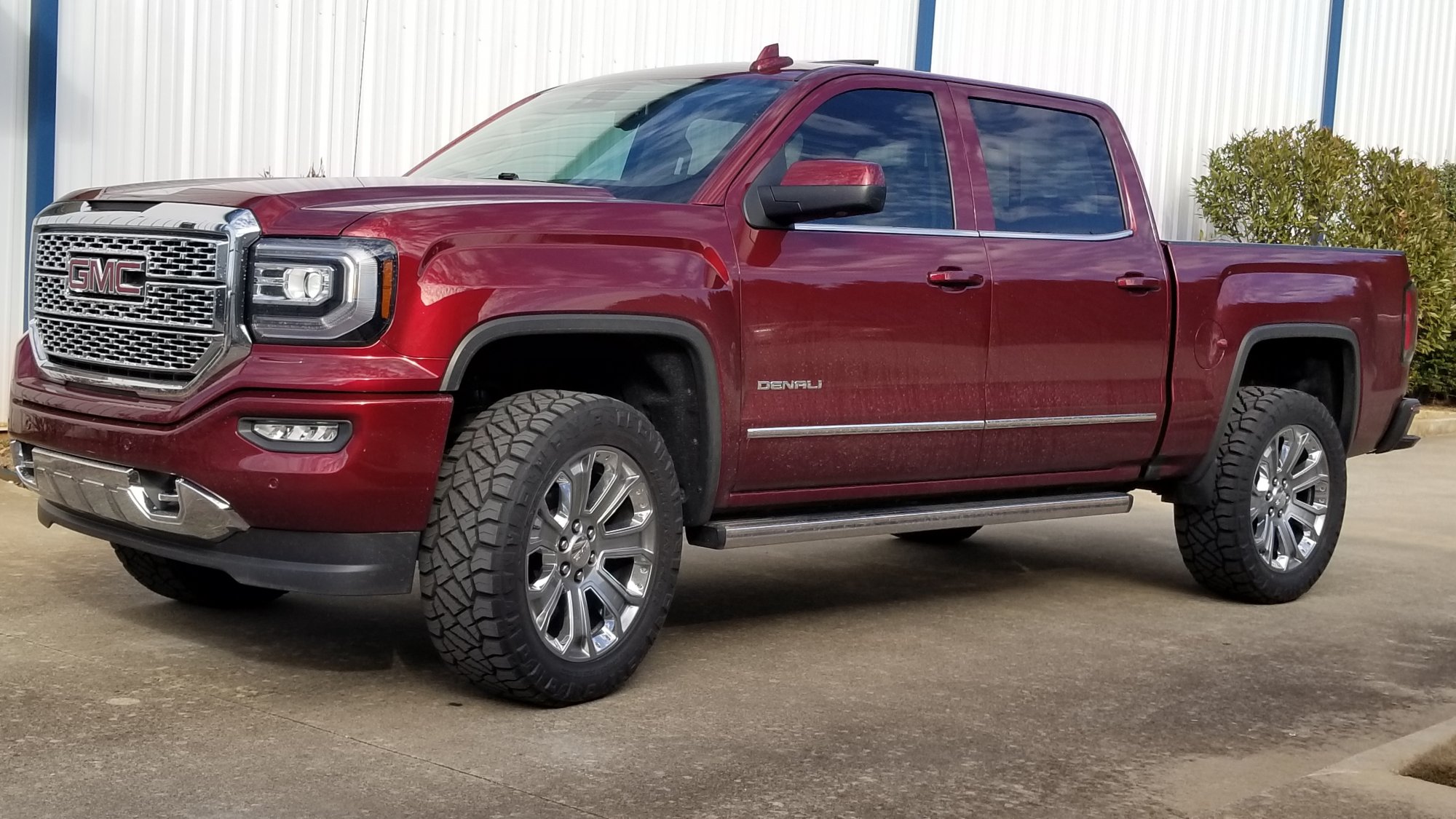

I installed a 2.5" Level from Suspensionmaxx with 2" Blocks in rear of my 2017 Denali. It rode just like factory before I put the 10Ply Ridge Grapplers on and it still rides great. I rode around for 2 weeks before tires and couldn't tell a difference except truck looked like it skipped leg day..lol

With the 2” in the back and 2.5 in the front, do you still have a slight rake down in the front?
Yes it is a little less than factory but I pull a boat year round and didn't want the squat. I'm glad I did as some look like they are a little high in the front. The suspensionmaxx has the bracket relocator for the magneride and have great instructions. If you decide to do it yourself let me know and I can give you a few tips to make it go quick! Here is a side and front shot

Truck looks good!  What size Ridge Grapplers?
Thank you. The side shot shows it well. Did you reprogram your speedo when you switched to taller tire? I had a bully dog in my last truck which was a diesel.
