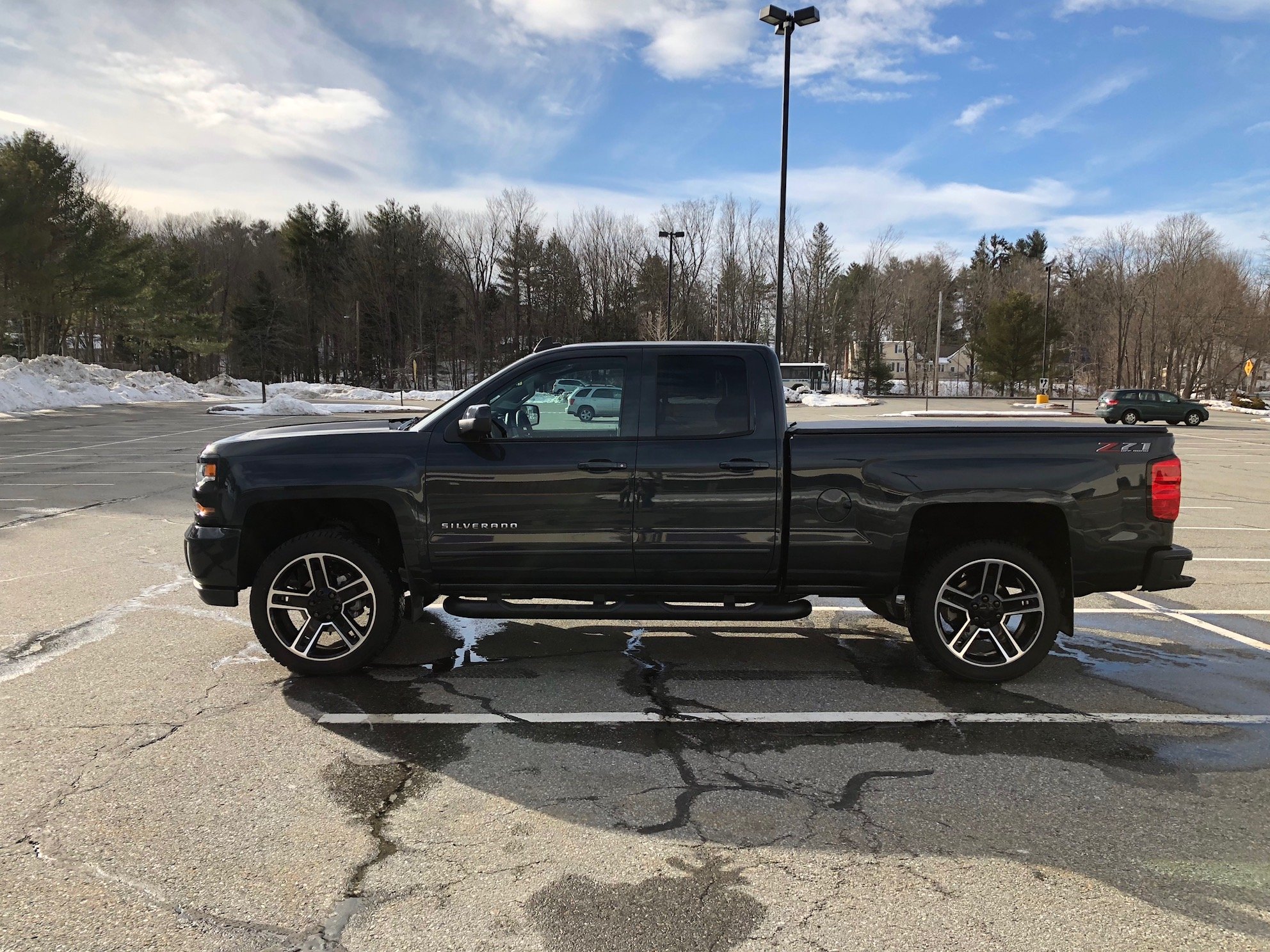

Just got the ReadyLift 2.25" leveling kit installed and replaced the the stamped steel UCAs with the ReadyLift tubular UCAs.  Stock block in the back.  Stock wheels/rubber (Bridgestone Dueler A/T 285/45/22s)
Edited by TRG

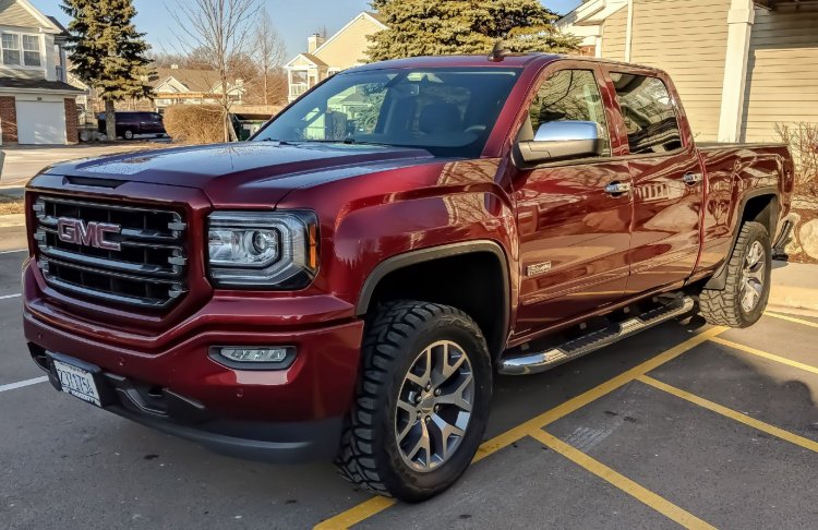

IMG_20180321_205646_01.thumb.jpg.39e58386457a0e106d542074ecf13a68.jpgBought my 2017 Sierra SLT All Terrain in January. Installed a 2.5" motofab level and 33x12.5 Open Country RTs on the stock 20s. Rubbing upper control arms at about 25 degree wheel turn. Ordered BORA 1.25" wheel spacers. Hoping this will correct my rub!
Edited by MHardiman90
