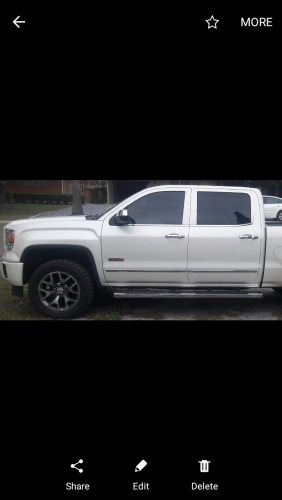

The Bilstein shocks are a great choice. Many on this forum including myself use them with no issues. Your best bet is to measure your truck on level ground from the bottom to center of wheel wells front and back. Different trucks have different heights from front to rear usually around 3 or so inches which is called rake. Some trucks exhibit more rake than others meaning they are 3.25 or more inches higher in rear. Usually a 1.75 to 2 inch level will make trucks appear even front to back. A larger level may give a "nose high" impression. Currently I have a 2.5 inch level kit with the Bilstein 5100's set at stock height. Nothing done to rear which is at stock height.
looks great! exact stance id like mine to have
