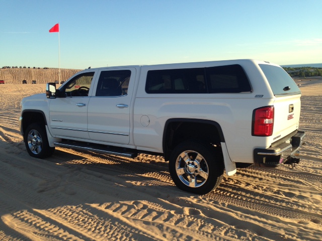

I run mine at 15psi up front and 10psi in the rear, 15 up front so I don't roll it off the rim. The locking rear end and down hill speed control really help here. The speed control acts really weird but it really slows you down. Going down steep dunes was a perfect test. This is Silver Lake Sand Dunes in MI.
