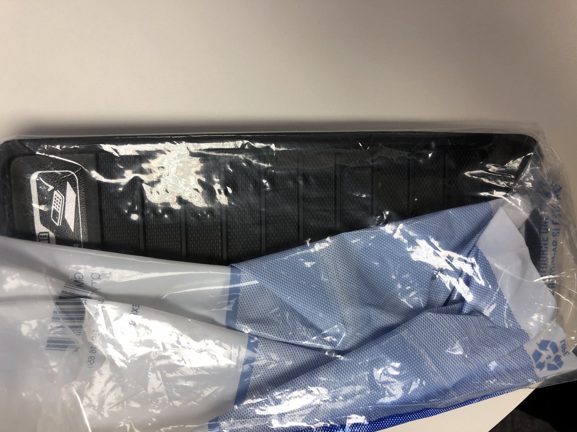

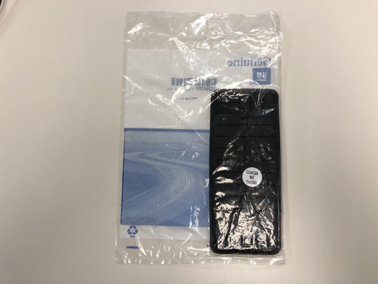

I clarified with him what I was looking for. I gave him the VIN for a 2018 Yukon Denali to use. He gave me p/n 23264395 and said it was about $9.
Here is a better picture of the back.  Only 9 ribs.  You would think that if they revised a part, that it would have a different part number.  If they are using the same part number as the old 9 rib rubber piece, it is going to be difficult to try to locate the new 10 rib batch.

I just returned from my local dealer.
The charging rubber mat is still listed as 23264395. I ordered one, and am hopeful that it is the latest design. It is listed '16-'18
