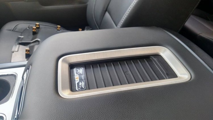

2 hours ago, JacobC1983 said:
Has anybody replaced their console lid with one from the 2018 truck that has the updated charging station?
2018:
39.jpg?wtrmk1024
My 2017:
The lid appears the same. The rubber pad appears different at the rear to accommodate longer phones. Curious if the charger is a more powerful unit.

8 hours ago, Tattooo said:
I wonder if the rubber pad could be swapped or if you need to change the whole lid ?
Absolutely. I swapped out the bezel on mine with one for a Yukon Denali. They come apart easily. I will need to find the 2018 part number.
Before you go an buy one and swap out. Try taking the rubber piece out and flip it around. so the lip is in the front. I was having trouble charging my S8 in my 2016, but after I turned the rubber piece around it charges just fine. It moves the phone closer to the back about a 1/4 inch. Just enough to hit the sweet spot on the charger.  You will have to cut off a small nub on the bottom of the pad that is used for alignment. Very easy mod and works like a charm every time I pop the phone down now.
O.k thanks, is it hard or does it just pop out ?
