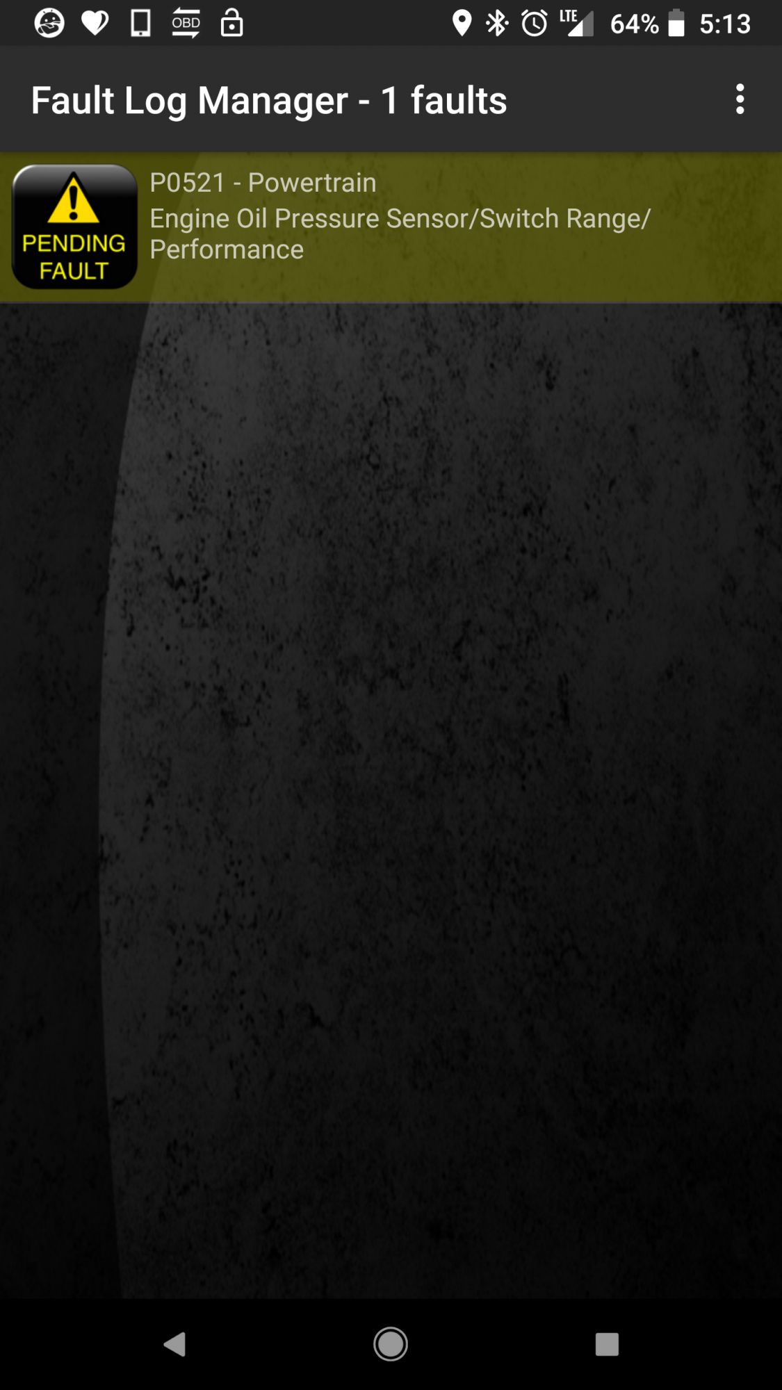

Roscopcoletrain Posted January 2, 2018 Share Posted January 2, 2018 So was in my way home today, notice the pressure gauge would drop some, than go back to normal. Then my cel came on. As I pulled in my driveway, got the dreaded low pressure, shut off engine message. Hopefully just a sensor but another suggestions? If it's just the sensor, I assume it's still fine to drive? Link to comment Share on other sites More sharing options...

swathdiver Posted January 8, 2018 Share Posted January 8, 2018 P0521 is a bad sensor code. Link to comment Share on other sites More sharing options...

Roscopcoletrain Posted January 10, 2018 Author Share Posted January 10, 2018 On 1/8/2018 at 6:05 PM, swathdiver said: P0521 is a bad sensor code. assuming its just a bad sensor then, the truck should be ok to drive eh? Link to comment Share on other sites More sharing options...
swathdiver Posted January 10, 2018 Share Posted January 10, 2018 Well, consider this scenario. If your oil pump pick up tube o-ring fails how will you then know before the motor destroys itself? Minimum oil pressure at idle is about 6 psi so if you have to drive it, do so sparingly until you can change that part out. If running synthetic oil, you've given yourself a larger cushion of protection. Link to comment Share on other sites More sharing options...
