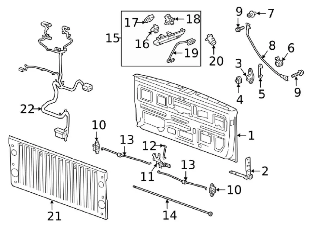

Owners who experience this issue or believe they may have water intrusion into their tailgate switch assembly can contact their dealer for a repair. Chevrolet and GMC have specified that one or two new switch assemblies should be installed to fix the issue.
For owners with a Multi-Pro or Multi-Flex tailgate, a replacement part number 85626238 should be installed to fix the inner tailgate switch.
The main tailgate switch should be replaced using part number 85626239.
