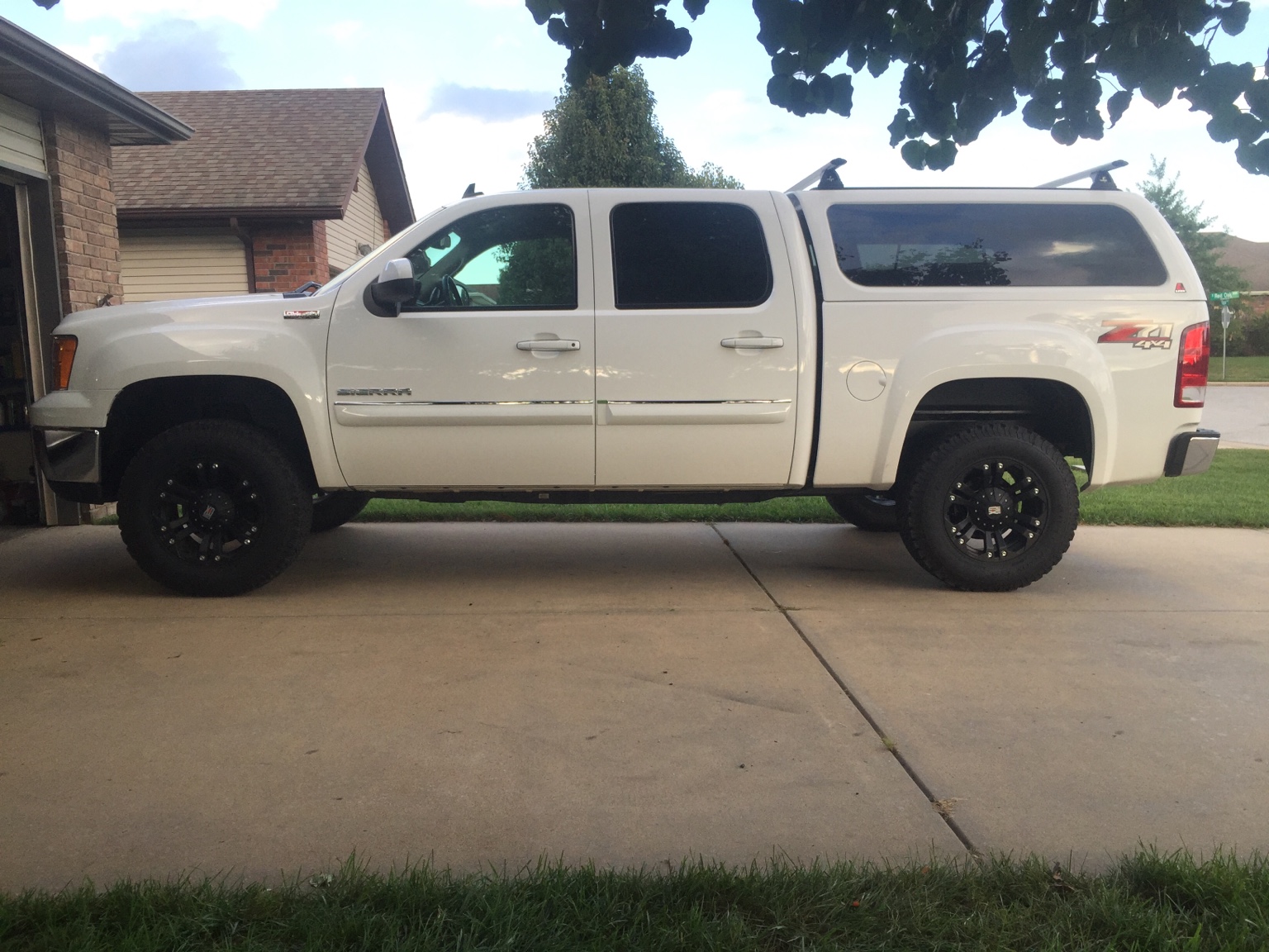

Exactly what I've been wondering
Matt,
I just put add a leafs on my truck after researching for awhile. The ride quality is great. I was skeptical but I love the way the truck feels with the add a leaf. Cheaper and more durable than a air bag and it's the right way to permanently raise the rear 1.5 inches. I bought the zone off road brand long AAL. I do have a camper shell and I imagine that 200lbs help smooth things out. I did bilstein 5100s also. Trust me if you are looking to lift the rear of your truck and add some payload capacity you won't be disappointed with this setup. post-131039-144244495858_thumb.jpg

Thanks for the input, appreciate when guys give good follow ups.
I also have the canopy and am thinking of that route as well. The rear end is going to wait until spring for camping season.
I have the bilstein 5100 0-1" lift rear shocks sitting on my workbench and fronts on backorder...no not sure if the add a leaf will be just a little too much for that shock. What shocks are you running in the rear?
Sent from my SM-G920W8 using Tapatalk
I have the ones designed for the 3" lift and I think you will be fine with the shocks you have. Mine are almost too long. and I have a 3" block in the rear.
