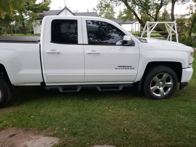

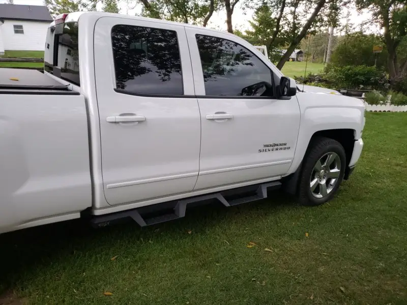

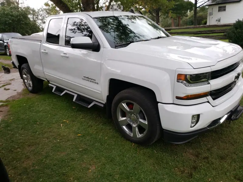

Installed the Westin HDX step bars on my 18 Silverado double cab today.. install was so quick and easy that my wife installed them .. that is after I figured out how these go together. I will post my learnings here to help any other members who wish to install these bars. I love the look of these bars, seem sturdy and well made.. but the instructions seem to be a product of Google translate so do yourself a favor start by throwing them out and follow the steps below instead. Assembly There are 3 mounting brackets on each side A,B,C.. C (longer one) goes on the rear door with the tab under the rocker seam, B (shorter one) goes on the front door with the tab over the rocker seam and A (welded one on the passenger side) goes in the middle. The long bolts go on the rocker mounting clips and the short bolts go on the step bar. Attach all the brackets finger tight to the step bar Installation Place the supplied nut clips into the rockers at the corresponding locations. Lift the step bar up into position and bolt it up.
