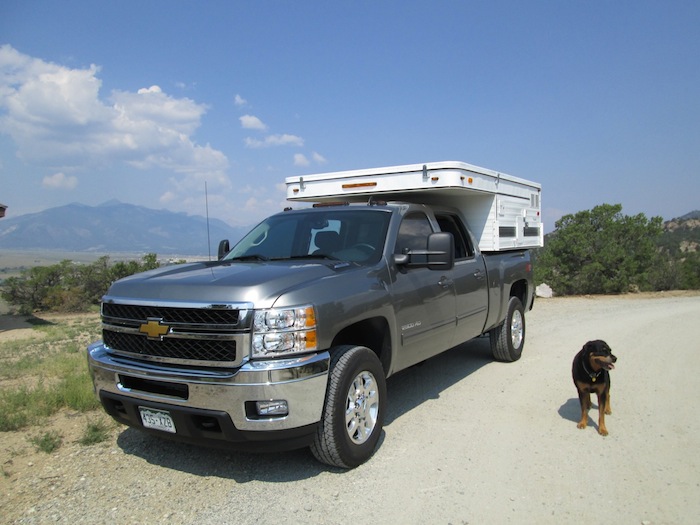

Had mine for a year now, great truck and the 6.0 gas, 3:73 with the new 6 speed trans is a great combo with plenty of power. I have a camper on mine full time and have no trouble with the 12,000' passes here in Colorado. No need for the expense of a diesel unless your dragging around real HEAVY loads.
