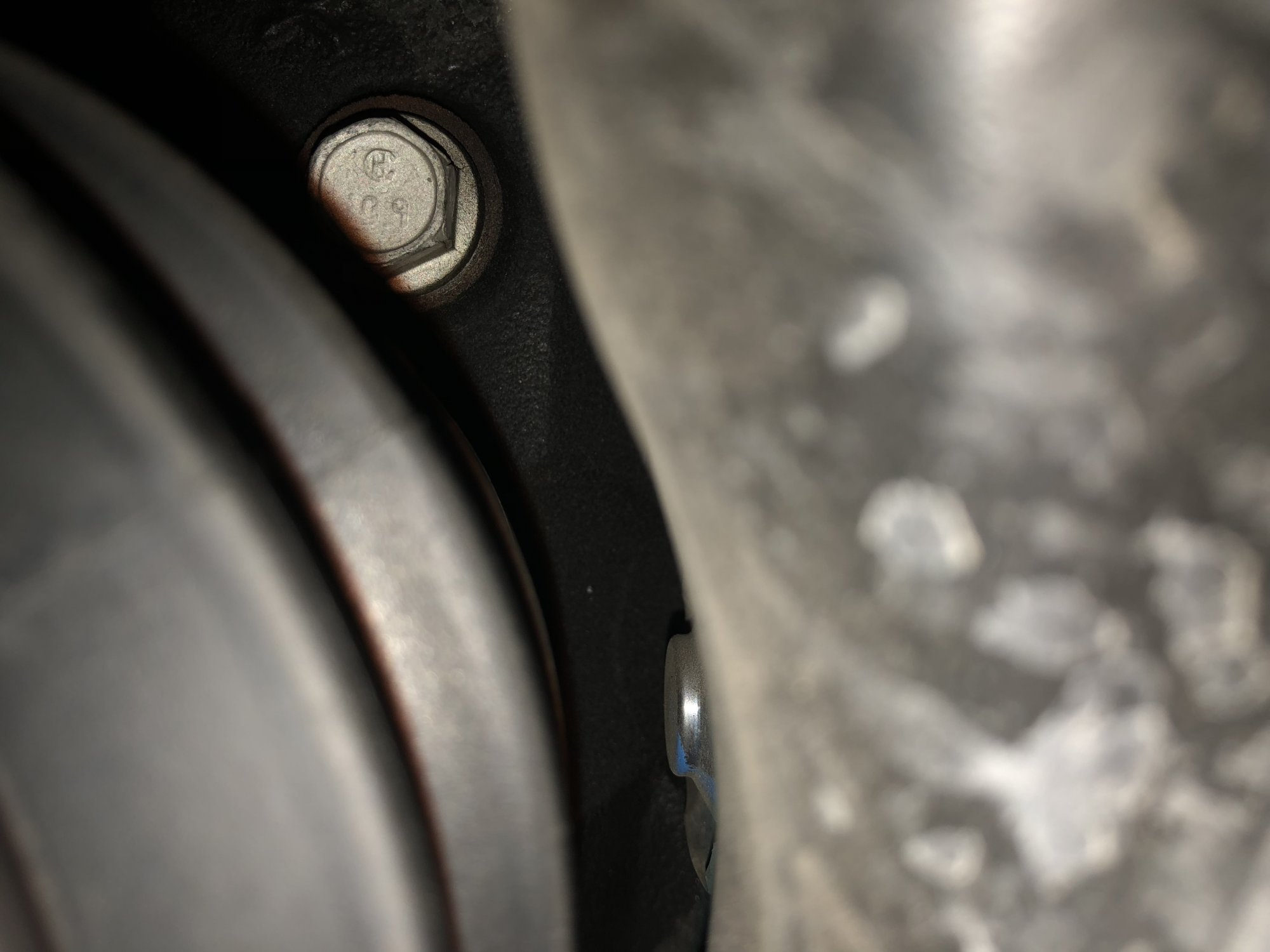

I have a spacer on the top of the strut and one under the strut, if you zoom in to the pic you can see the black Rough Country spacer under the strut, 2.5” kit
I see it, You should be good as long as you have space between not touching.
Geez, the stuff I do! Just sent to my tech guy at 4wheelparts and he said looks good just keep an eye on it to make sure it doesn’t start rubbing. Looks good, go to sleep lol

Got me all fired up, moved a bunch of crap out of the way, shuffled cars and pulled it in the garage just to be sure, side shot of the clearance on each side sitting only on the minor slope of the garage, pictures are looking out towards the face of the wheels, not sure why they uploaded sideways
You’re good, go get some rest, God Bless
fyi the front axle still spin even if your not in 4x4... so if the cv touch even driving in 2x4 will be bad
Hope everyone got that!
