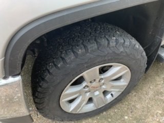

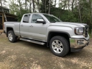

Well, here it is. My 19 limited. I installed the ready lift kit, 66-3086. Had my 275/65-20 ko2’s installed with a alignment done. The truck rides the same as stock, in my opinion. You do feel a little more of the road due to the e rated tires but it’s great. Feels more controlled than my 19 slt(new body style), which I didn’t like. I drove it home, cranked it full lock in either direction, over speed bumps and any other road imperfections that I could find. I can honestly say there was no rubbing anywhere whatsoever. I even have a set of husky mud flaps installed. It’s sits nice and level. I may ad the ready lift 2.25” rear block kit to give me back a little rake for towing and hauling. Overall... love it.
