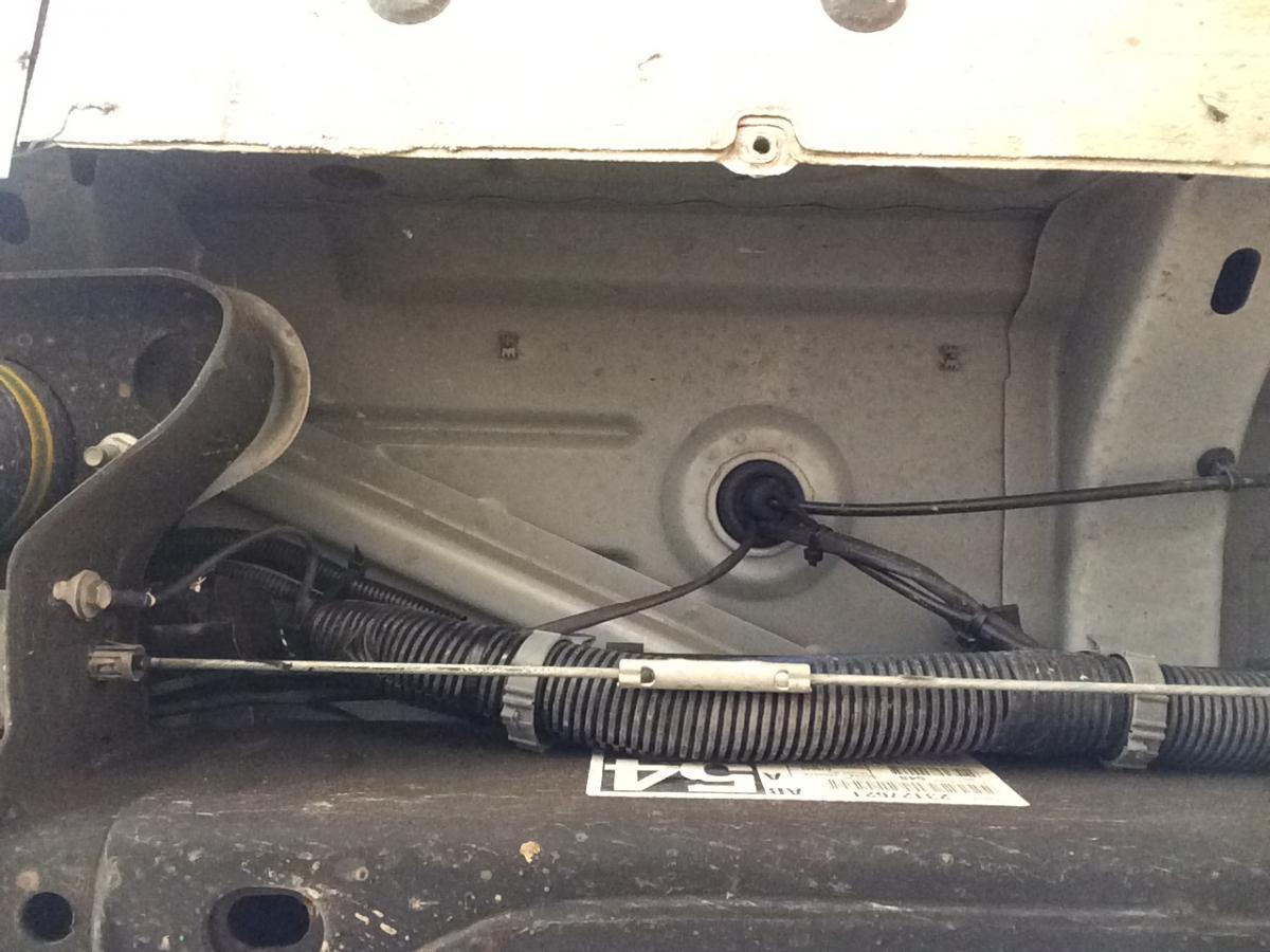

There's room right here in the stock grommet.
Still stuck at running the power from the engine compartment into the cab!
I have tried and can't get thru this spot... Mine truck is a 2014 Crew.
"Remove right side bolster" What the heck is that?
Edited by No Tyme

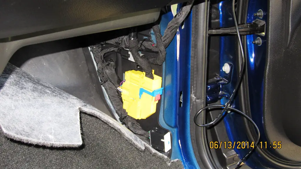

Upper firewall location:
Under driver's left foot location:
(see attached)
