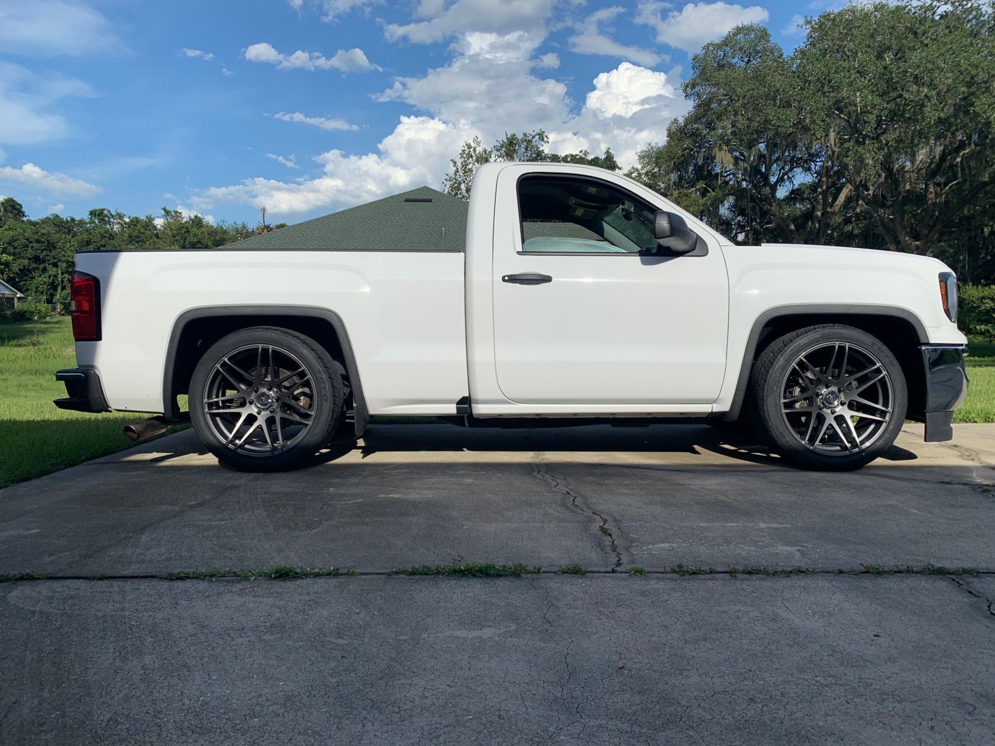

I just finished installing an adjustable 3/4, 4/6, 5/7 kit on my 2018 regular cab Sierra. I first installed it to be 4/6 but was not happy with the look. Looked to high in the back. I then installed the factory hanger back and it gave me an additional 1-1/4” drop. Now it looks like the front sits a bit higher in the front. Front is Maxtrac 2” spindles with Belltech struts set at 2” drop for a total of 4”. So apparently I am now at a a 4/7.25.
I am trying to figure out how to get the front just a little lower without running into rubbing issues.

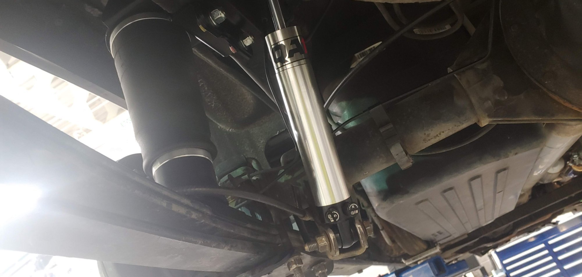

First time posting on this forum. Been on a few platforms. This Ol'Gurl is my forever truck. Not my first foray into the slammed full-size or mini but definitely threw all the goodies at her to be a daily useable truck.
Info 2014 Crew Cab Z71 4WD
IHC 4/6 drop kit Front and Rear, dialed at  according to my comparison from ground-to-fender measure on a 19' Z71 she sits right at 4/6 and within spec on alignment.
  • 4" drop arms (Front)
  • Belltech 2-Way Adjustable Coilovers (Front)
  • Axle Flip kit (Rear)
  • IHC Shackle Flip Kit (allows for cleaner travel of suspension, simply shoving lowering shackle onto system was rubbing frame)
  • IHC 1" drop shackles
  • IHC Firestone helper bag kit (Rear)
  • QA1 2-way adjustable emulsion shocks (Rear)
    • Design and Machined custom bushings to accept the shocks
Wheels and Tires 22x10 square ET +0
  • Cosmis racing XT-206R (finish chips easily but they also clean up easily)
  • Lionhart 285/40/22 (Surprisingly nice ply and quieter than anticipated)
First day I finished her she had that stupid SC Squat because of the cheapo "nitro drop shocks" and spacers IHC recommended under struts up front. Once I installed QA1's, shackle flip, helper bags, and removed and readjusted coil overs I got her squatted on all 4 corners. I rub in front occasionally on full lock to drivers and over excessive dips in road mostly in front. I have bumped coilovers up 2 clicks from factory on drivers and 1 on passenger. Bottomed out axle and pumpkin constantly prior to installing QA1's and helper bags. Have compression up 2 clicks from middle and run helper bags with 8-10lbs in them when bed is not loaded up.

At 7.25 how close is your axle to your frame rails?
