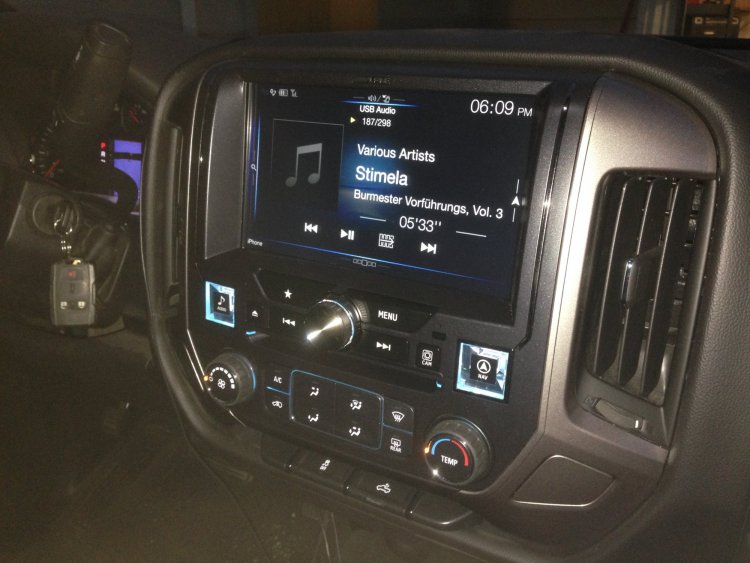

Installed ScanSpeak ring radiator tweeters using some adapters I made from 1/4" abs. My Original plan was to install them on axis in pods on the dash or a pillars which my experimenting showed gave the best response  but decided to keep it stealth and just put them in the stock location.
Also took apart the headunit to run the RCA's and remote wire for the amp as well as hook up the bass level controller. I probably should have done it when I originally installed the headunit but it wasn't as bad as it looks.

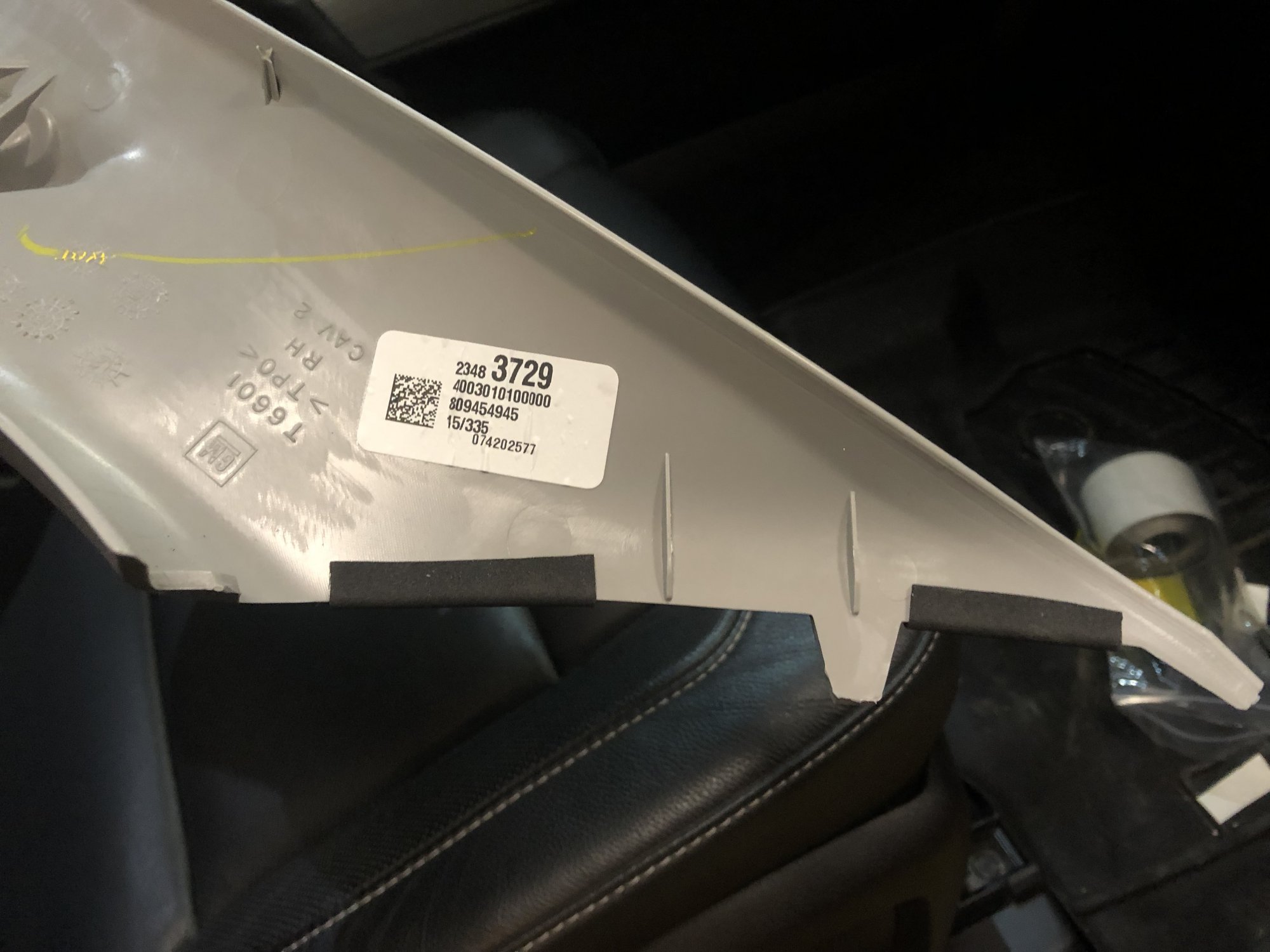

Pulled off the A-piller trim and front dash trim to hunt down a rattle between the dash and left A-pillar. I added some foam tape along the bottom of the pillar trim where it fits into a slot in the dash trim.
