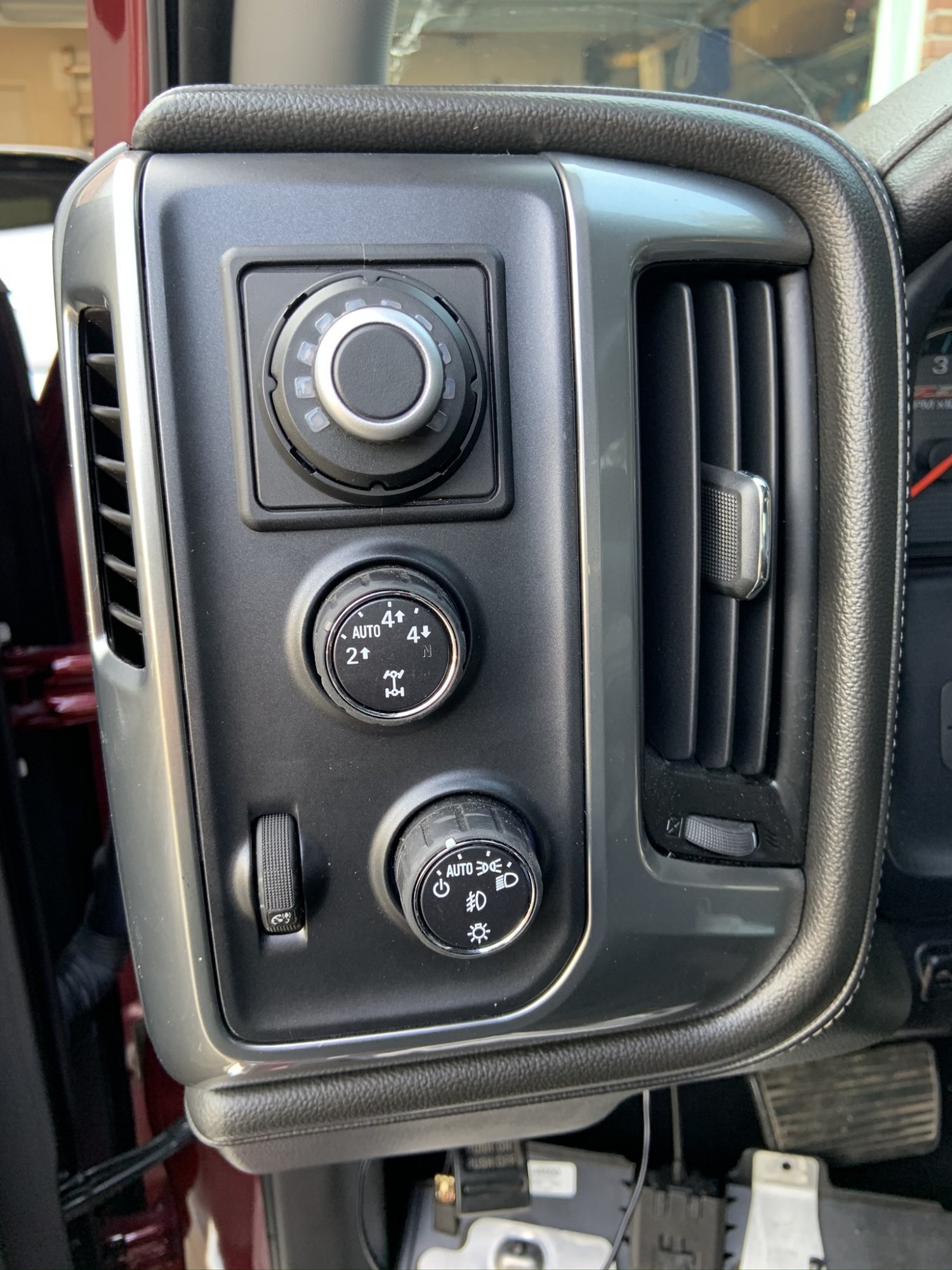

The brake controller I bought from etrailer.com the other parts I bought from https://www.otrattw.net
these are the pieces I ordered:
SKU Product Item price Quantity Total
VME-01 Snap-In V-Series Switch Bracket, End, Set of 2 $3.50   1 $3.50
VHP-CAR V-Series Panel Plug $1.35   2 $2.70
Subtotal: $6.20
Shipping cost: $4.00
Total: $10.20
then I ordered the switch bezel for models with the factory brake controller (GM Part #22830877). I used a dremel to cut out the opening to accommodate the switch plate. It all took me about 90 minutes to complete.
