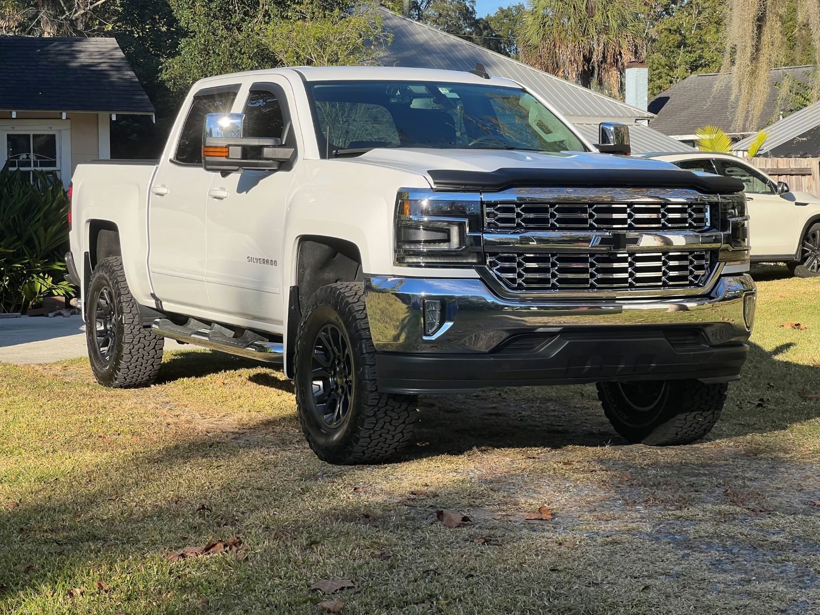

The full oem air dam is a bit much. I never cared for it but needed it because of the front plate. However, I did learn that it is actually a 2 piece. Quite a while back, I removed the bottom piece and think it looks tremendously better and provides more clearance for the reason you mentioned...

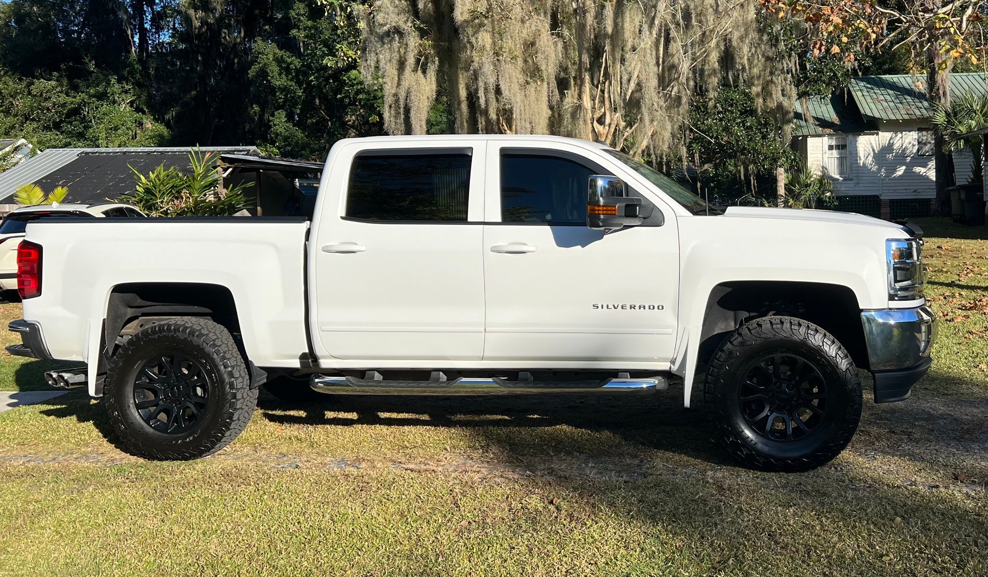

Wow, well that backfired. I guess pictures are needed.
I only removed the lower air dam. In the summer I put it back on. You can get severe overstear with high speed cornering, and overall driveability is affected.
Yes, I am aware of what it does. It ensures a low pressure area under the vehicle so that hot air is drawn down and out. In turn this pulls air through the radiator.
Cooling isn't as efficient with the lower air dam removed but it still functions. If you have larger tires with a level/lift your likely not to notice or need be concerned about the handling differences.
*edit*
I forgot to add that the reason for the difference in handling is because the front air dam creates down force.
I actually get slightly better fuel economy with it off. Truck feels lighter.
But I could also blow the tires off if I floored going when going 100 kmph (on cooler days).
