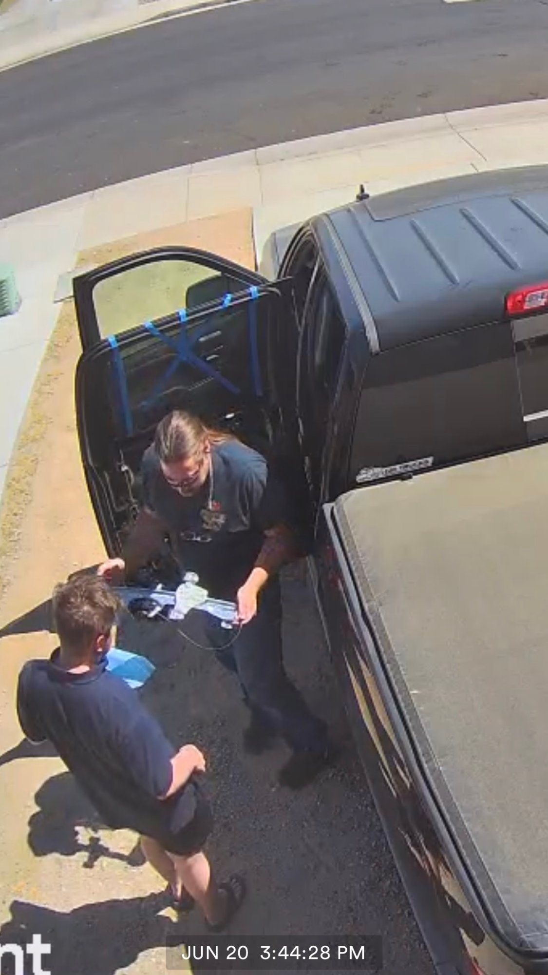

Replaced the left rear window regulator on Monday (Photo #1), the window "fell" on Sunday afternoon, and it's raining today (started around 1:30am).  Photo #2 was taken around 8:30am, the lightning strike struck a motor home about 2 miles away, caught fire (photo #3).

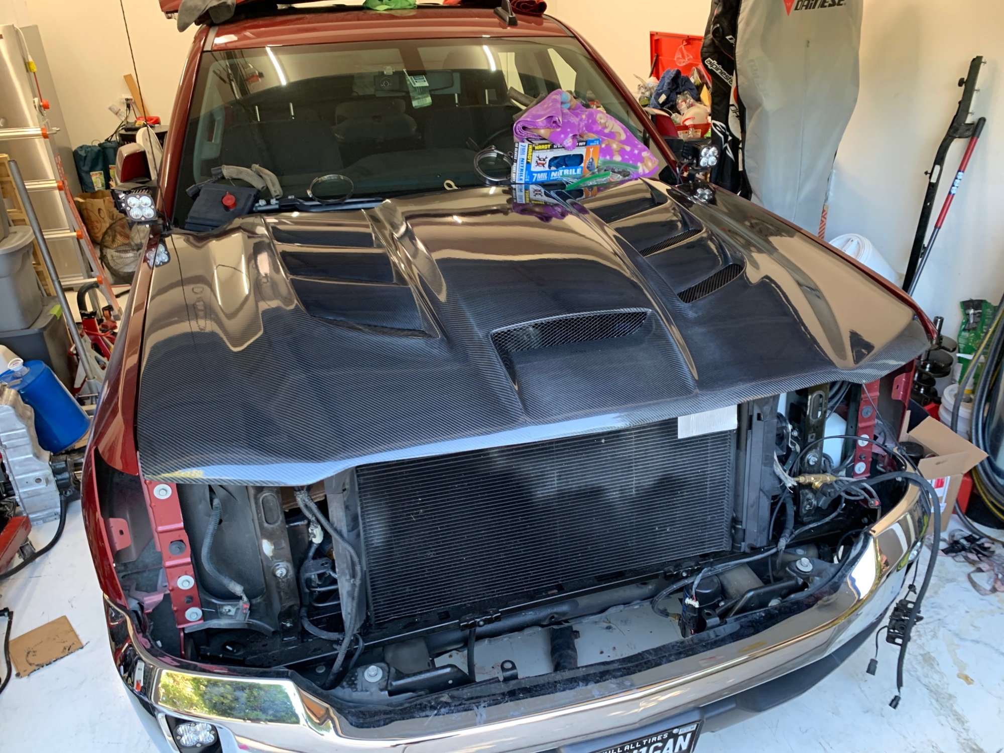

Carbon Creation Viper hood… it’s not bad bad but I expected better quality. There’s a bunch of tiny white speckles all over the hood. Looks to be mixed in the clear coat…

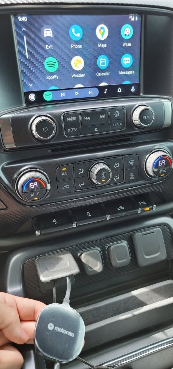

Picked up a wireless Android Auto adapter(Moto MA1). Giving it a try, so far so good. Connects within a couple secs.
I have the magnetic charging cable for my phone, so wasn't a real hassle to just connect it wired. But wanted to try the wireless option. Unless I'm going on a long trip, not plugging it in is nice. 20220709_093918.thumb.jpg.e8837a1b4991c63a1667a00c6e60433c.jpg20220709_094023.thumb.jpg.5c46e7c46fea498137839844a9a3b806.jpg

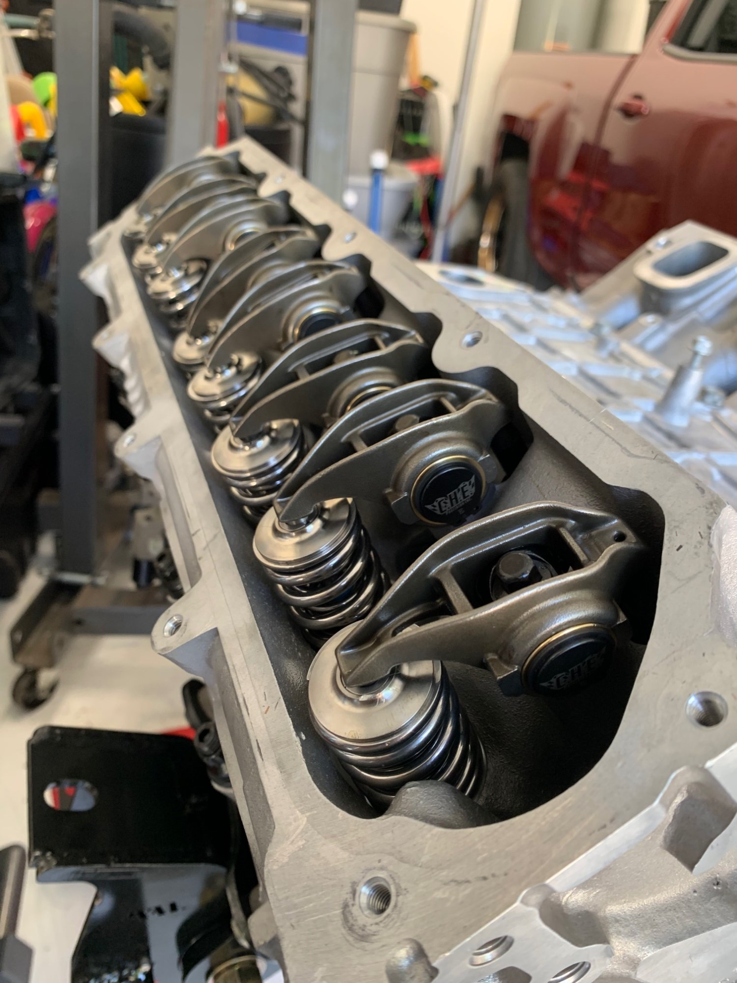

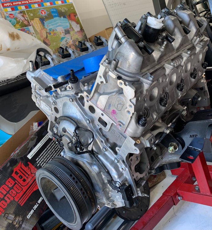

Finally finished putting the engine back together. Will be shoving it back into the truck this weekend.
GPI drop-in pistons / rods combo
L86 crank
ARP main and head studs
BTR .660 dual springs
CHE trunnions
Cam Motion custom LT turbo cam
AFP engine mounts
