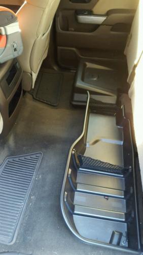

Installed the gm kicker system and modified the under seat storage to fit.
Sent from my SM-G920R7 using Tapatalk
That is what I want to get next for under seat storage. Did you cut off the one side near the sub, or trimmed around it?
I cut off one side and drilled new holes for the net to close off that end. I also reshaped the passenger side storage bracket and mounted it to the rear driver side center seat belt anchor and drilled a hole to attach it to the storage bin to keep it from moving.
