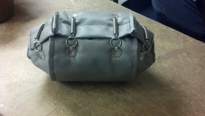

I thought about installing a thermal and sound suppression exhaust blanket around the cat, like the one in this picture just to see if it would make a difference.
