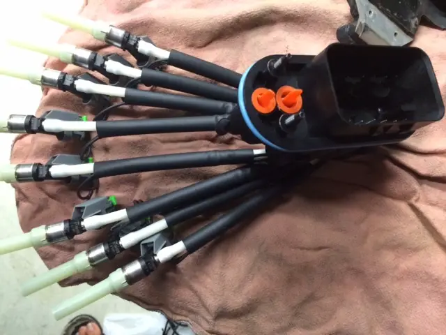

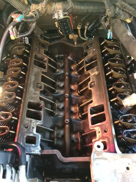

Then the fun began...Changed upper and lower intake gaskets and upgraded from CSFI to MPFI.
Fired right up then began to run shitty again right away. I checked and checked again to make sure that I had TDC and the Distributor was in the correct orientation on #1. Thought that this has to be a timing issue and threw a timing light on just to see, it appeared to be severely retarded. I took it to a shop and had them hook to a scan tool and it was -27 degrees. They tried adjusting then checked to make sure that it was TDC on #1 and verified. They had no idea but suggested that I start with a compression check, which I did. Values as follows:
