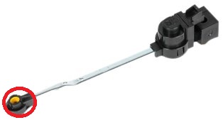

Adding thin UHMW tape to the metal shaft made it a tad bit thicker. Just enough that it slides freely and doesnt move as much. Also I found that its not the solenoid device itself making the rattle, nor is it the metal shaft inside the plastic.
For me it was the rubber bushing that connects closer to the driver seat (circled in attached pic), it seemed to be partially worn out and it had some play. Causing the plastic to tap against the metal bracket that it connected to. I popped it off, wrapped some electrical tape around the little metal ball that it clipped on to and then popped it back on. It now has very little play and my shifter is no longer stiff.
