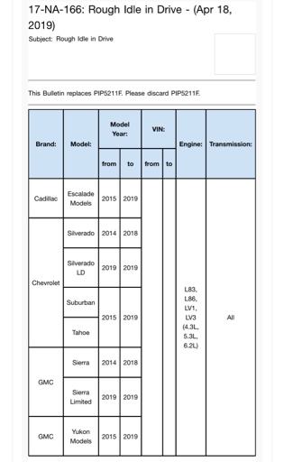

Are you throwing anymore codes? I had a shutter at idle while in drive after the car has warmed up so I did some digging. There is a tsb out for motor mount replacement for that exact cause. Had mine done last week. I’d say it’s about 95% corrected.

I ran my code reader / data logger yesterday and no codes or for that matter unusual idle conditions. It is just frustrating that it doesn't happen enough to pin point the issue. Again, I don't think this has anything to do with the dealer as they can only do what is present and I totally understand that BUT I still think it is something that if not addressed will kick me hard when the warranty expires next spring / summer.
