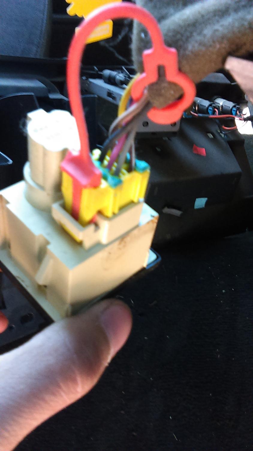

Took apart my dash today and it looks like the air bag is still in the passenger side. Don't know what it's supposed to look like but its all folded up in there. Also found the connector unplugged for the passenger airbag. It is obviously unplugged because the two connectors are completely different. Someone must have replace the entire dash and it must be from a different year or model. Also I looked at the cluster and someone broke off the little bulbs for the brake ABS and air bag. It looks like they unsoldered it so I think I can solder them back in if I can get the computerboard off without breaking it. Does anybody have any idea what model and/or year my dash might be from? Is it possible to hardwire the two connectors together even though one has two wires and the other has 4? How do I solder new LED bulbs on board? Thank you very much.
PIC 1: Top connector from wrong dash (goes to pass airbag), bottom connector from truck harness
PIC 2: Pic of passenger airbag on/off connector
PIC 3: Diagram of pass airbag connectors and wire colors
I had it inspected by the GMC dealership and they said everything was solid. Of course they didn't scan for codes. Except for the dashboard/airbag issue everything is fine. I think someone replaced the original dash with one from an 04' Sierra. This would explain why it still fits correctly but some of the connectors are different. Is there anyway to hardwire the two different connectors for the passenger airbag? I have the pinouts but I'm not skilled enough to decide if I can splice them together.
