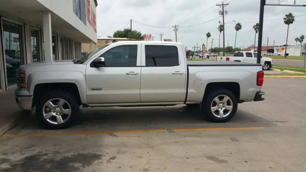

Pic Request for 275/60/20 vs 275/65/20 BFG KO2
After a few weeks of having my 275/65-20s, I've noticed a drop in my mpg by about 2. I didn't lose any when I leveled it or when I removed my air dam, but the tires did it. I did notice that before I installed the tires my truck went into V4 mode a lot, mostly because how I drive. But now it almost never goes into V4 mode. I think having more weight and size causes the engine to be under more load preventing V4. Even when going down a hill and with me letting of the gas it doesn't seem to want to go into V4. I'm still glad I went with this size, i love the way it looks. Just something for future buyers to think about.
I wonder if there's something that can be calibrated with the tranny or ecu to change that.
