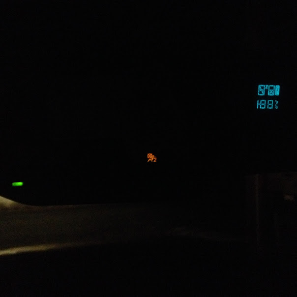

I bought a mirror off of ebay that had the compass and thermometer on it as well. The "new" mirror came with the old wiring connector and it has the same wires as I have on my truck.
Plugged it in and get this on the display;
I tried a new ambient temp sensor today but no change.
Any ideas?
Thanks
Got it! Took the mirror down again, there's a little circuit board behind the trim piece right where the mirror bolts to the windshield. Circuit board has a plug-in and two silver boxes attached, each silver box is soldered to the board in two spots and soldered to a copper winding in the box. One side of the copper winding and one side of the box were broken loose, re-soldered those, re-connected and the display is back up and running.
