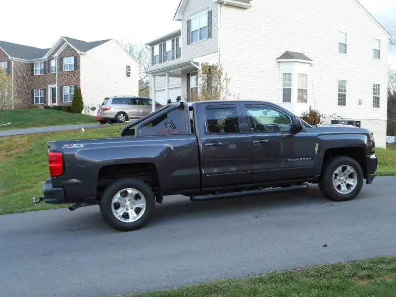

Bought the sports bar from the dealership.....knocked off 10% for $900.....has a prewired CMHSL which is powered from the fuse box under the hood. Also available over the internet, but not worth it since the shipping charges will exceed any savings.......weighs about 30 lbs but extremely bulky coming on a box that takes up the whole bed.....let the dealer absorb the shipping!
Front part mounts on top of the rail in a stake hole........back protrudes 3/8" on the sides of the top rail where most roll up tonneau covers mount but a total 3/4"variance in width shouldn't interfere with the rollers......leakage over normal leakage for a roll up shouldn't be too much of a problem using a little silicone to take up any slight gap

What does this "sport bar" look like?
Looks something like the "sail" on my old Avalanche or the "wings" on my '69 Chevelle, but a lot meaner. Like the photos show.....mean

Just installed a Lund Genesis rollup cover.....the sports bar does not interfere with the mount........only change wasa installation of and extra 3/8" foam insulation to take up the difference where the bracket overlaps the side rail cap.

Nice sport bar Thomcat! I am going to pick mine up tomorrow. Where did you find the installation manual or did it come with one? I want to also install a roll up cover.
There were no instructions with the sports bar. There is a sheet of paper advising to go to the dealer to have the instructions printed which I did and for the $900 (10% discount) they were happy to do so. Unfortunately I discarded after the install, but didn't follow them exactly anyway.
Mechanically a simple install......cutout the stake holes in the front bed rail cap and remove side plug below and fastener attaches from side and top, rear fastens under the rail and insert fastener. The trickiest part is loosening the gas filler and snaking the power harness for the CMHSL in the bar (the one on the back of the cab is blocked by the bar, but the bed lights which point downward are not) through the exposed hole to feed to the frame below.
I ignored the hookup instructions for powering the new LED CMHSL which involved pulling the fuse block off the bulkhead, removing the positive feed wire and substituting the new one into the harness to disable the original stop light and power the one in the bar. Much easier to buy an inexpensive a piggyback fuse tap which has space for the old fuse and a new fuse powering a positive lead.....left out the original fuse socket in the tap using only the new one which has the same effect of disabling the old CMHSL and powering the new one or could put in both fuses and both will work.

Easily removed without any remaining trace other than the removal of the plastic knockouts from the rail cap to expose the front stake holes for the install.....in fact removed the sports bar to snake the light bar wires and reinstalled.
