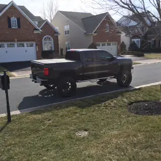

Here is a list of what's done so far
7-9" mcgaughy lift set to 9" with rear add a leaf 1.5" ss kit
Custom grill and hood scoop painted to match
37x13.50r24 fuel mud tires
24x12 fuel maverick rims with center powder coated to match paint
Extang solid fold 2.0 cover
Dual exhaust
Complete regear from stock 3.08 to 4.88 front to back with duragrip posi track
Diablo t1000 tuner
N-fab chrome side steps
5% window tint all around
54" curved light bar arrived today and will be installed this week

Damn, that looks really good man. Makes me happy to see a new body truck with 37s and a re gear. Same exact rims I'm looking to run. Did they have to cut any of the bumper other then the plastic valance? In your honest opinion do you think the 4.88s is over kill for the 37s? How does the truck shift now compared to before with the 3.08s? Thanks again man. Truck looks good, keep it up!
