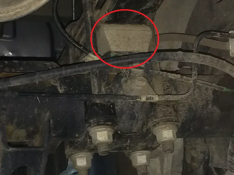

I wanted to level my truck and had no reason to raise the front end, not planning on oversized tires. So, I removed the 1&1/2" blocks from between the rear differential and the leaf springs. Used $9 worth of flat washers to make sure there was still some threads left on the U-bolts. The only reason it was $9 is because I stuck with metric flat washers at 14mm. It would have been negligible if I'd have used SAE washers probably at 9/16", but was just being fussy.

Very easy process, just undo the U-bolt nuts, remove the blocks, and put it all back together again. The alignment pins dropped right in. What a cheap and easy modification. Took less than half an hour.

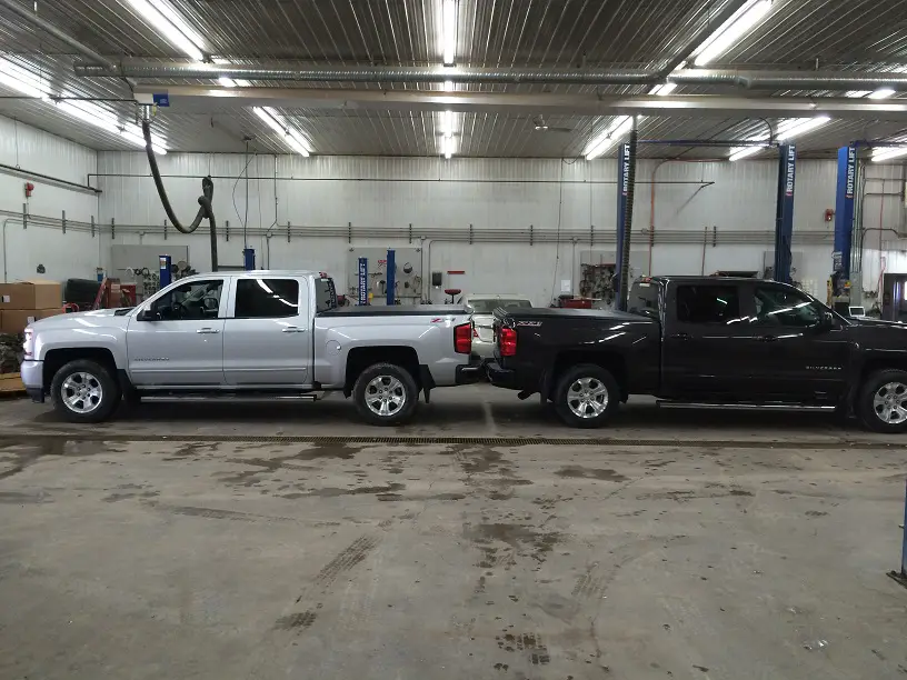

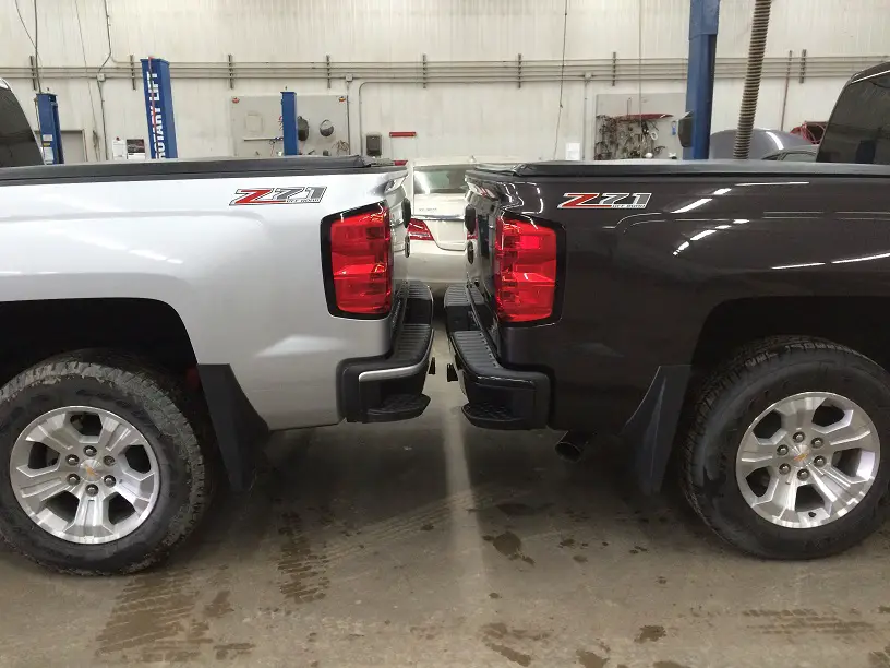

There is still 1&1/2" of height difference/rake in the top of the wheel well to the ground from back to front, but a 4 foot level shows running boards as spot on, so I call that level.

A couple pics now that truck got cleaned. I brought in a truck with identical RPO codes for comparison (except exterior color, otherwise identical trucks)

So, to re-cap, it's fairly simple. A 21MM deep impact socket is needed, remove nuts, remove blocks, reinstall nuts, torque. I put 2 flatwashers under each nut just to be darn sure that I was torqued and not out of threads on the U-bolts. This may not be necessary, but cheap insurance. Would have been a completely free mod if I hadn't used the 14MM metric flatwashers (16 total)
Forgive my ignorance, but what is the purpose of the spacers?
I was thinking of using lowering shackles, but I like this idea.
