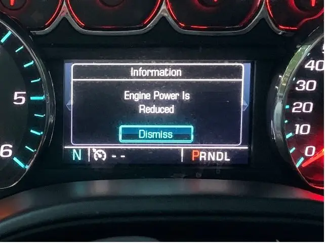

Just going through this, myself.  I brought home a new to me CPO 2017 Sierra with 27K miles on Wednesday last week.  Thursday morning it threw the CEL with codes P300 and P050D.  It had a rough idle and hard shifts.  I took it back to the GMC dealer I got it from and they are replacing the bank 1 injectors.  All covered by warranty.  If it hadn't been covered, I would have had some words with the dealership as getting 14 trouble free hours out of a truck this young would have been a "problem" for me.  I pick it up tonight.  Keeping my fingers crossed that this issue is behind me.
I also got the reduced engine power message.
Edited by dgravity
Added Image
They'll probably say no, but I'd call them up and ask to have the other bank done as well. Guys have had one bank replaced just to have the issue show up in the other bank. No sense in pulling all that apart just to be one easy step away from doing the other bank. The high pressure fuel lines have to be replaced each time new injectors are put in, so might as well do them all at once and consider it a cost avoidance.
