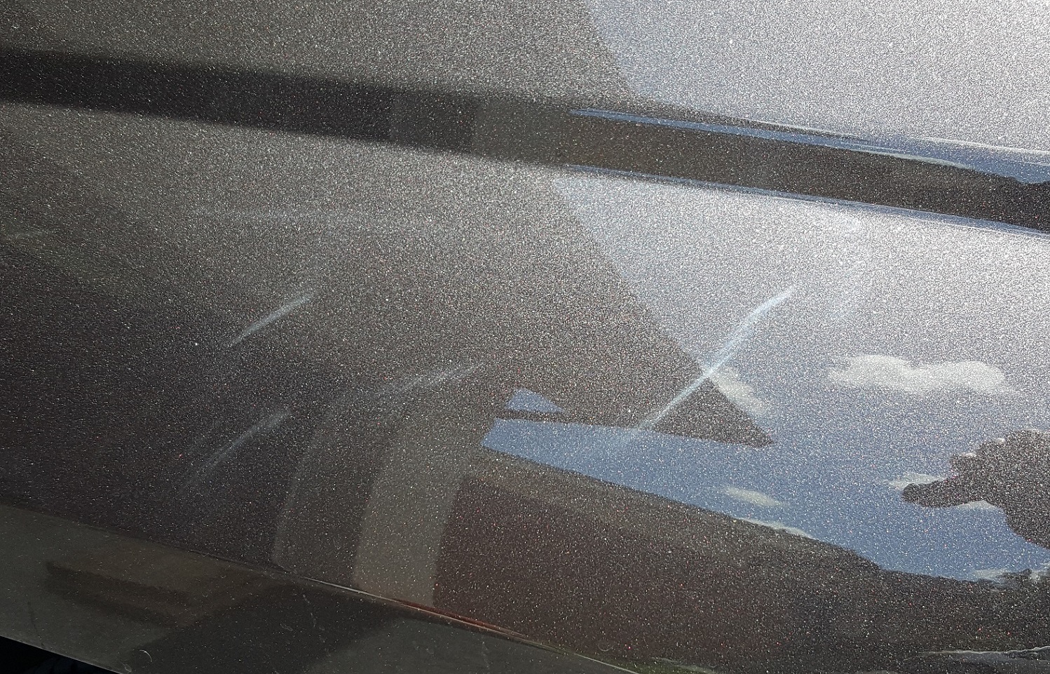

I'll post pics. It rained all day yesterday.
These are what I believe are buffed out spots from the dealer.
Maybe there were imperfections from the factory or train, and the dealer tried buffing them out but did a poor job. or didn't look at it form different angles.
Someone mentioned it above. They look like shadows in the black paint.

Those look like RIDS. Random Isolated Deeper Scratches. That can easily be buffed out with the proper compounds and polishes.
Probably something in the towel when it was dried.
