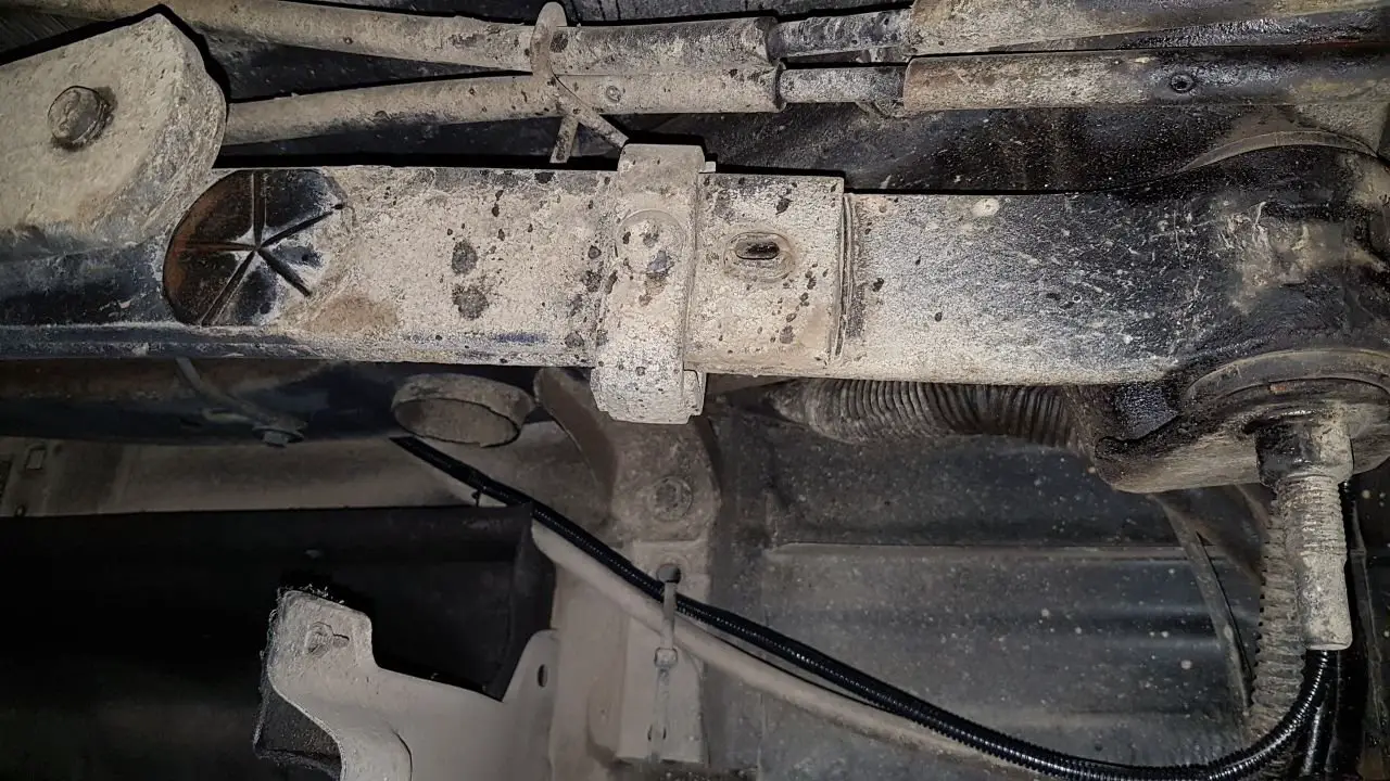

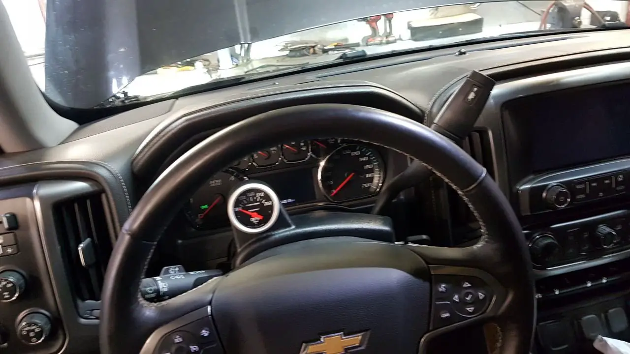

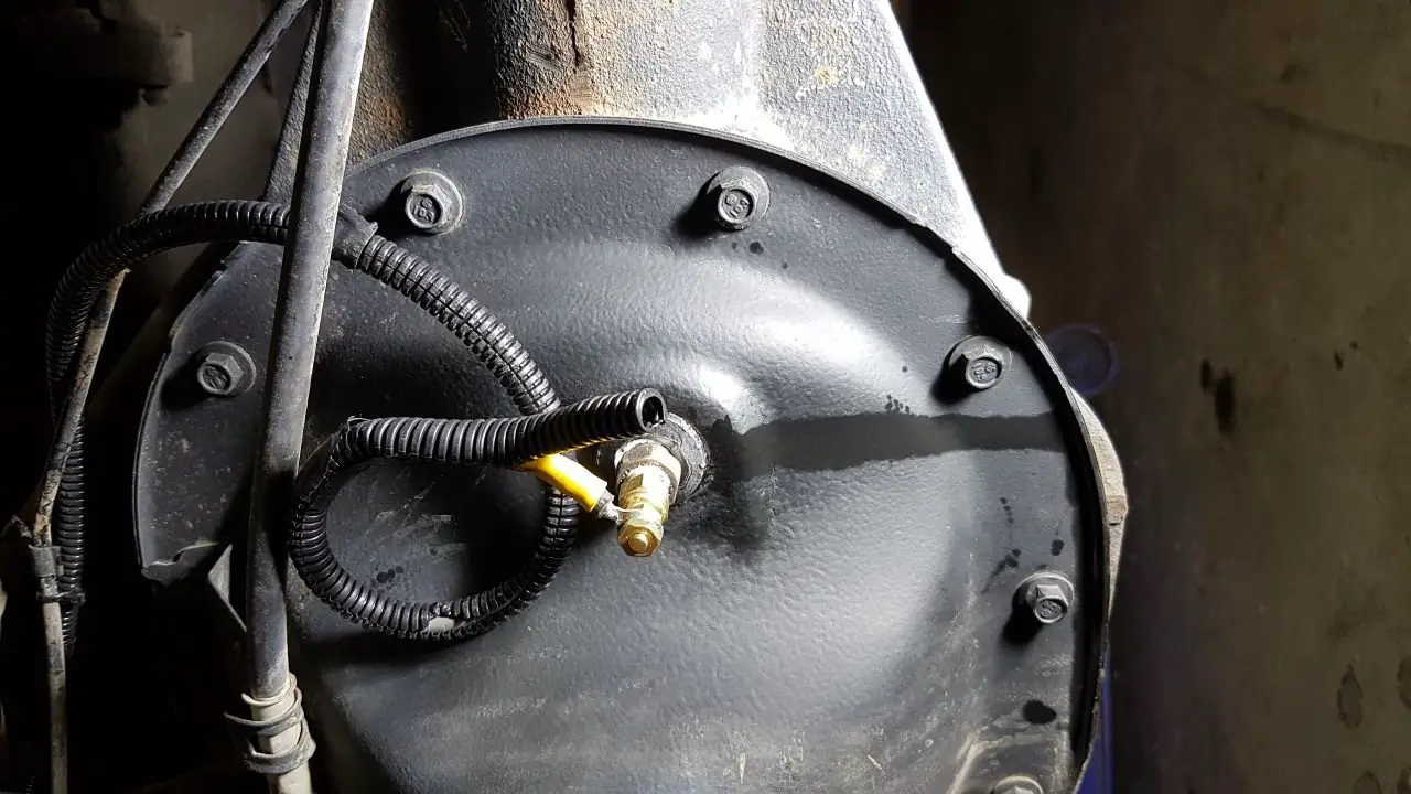

I bought this kit to measure the diff temp on my truck. I am going to run it for baseline readings. Later I am going to install an aftermarket cover from B&M. The pod was on line at amazon. I am going to pull my rig to BC and I will now be able to see what is happening back there. And I want to see if the new cover makes a difference.

What temps have you observed?
FYI Banks engineering is testing aftermarket diff covers. The results so far point to the stock cover being superior to some of the aftermarket.
Edited by 2009GMC
I towed a 71 duster 250 miles a week ago and saw 125 deg f and out side temp was about 28 dec f. Pulling I figure 5500-6000lbs. I am watching the banks testing closely. Very interesting what Gale has discovered so far. The idea of the fluid hitting the squared corners of the diff cover causes more heat and less fluid being carried up and over to lube the pinion and bearings makes sense to me. Fortunately the B&M cover I bought has curves similar to the stock cover and adds strength to the differental itself.
The place I installed the temp sensor on the stock cover is above the fluid level stopped and is probably in the coolest fluid area(was the easiest place to install) but it is right in the flow of fluid while running.

Aftermarket is the way to go especially with milled fins and large magnets.
