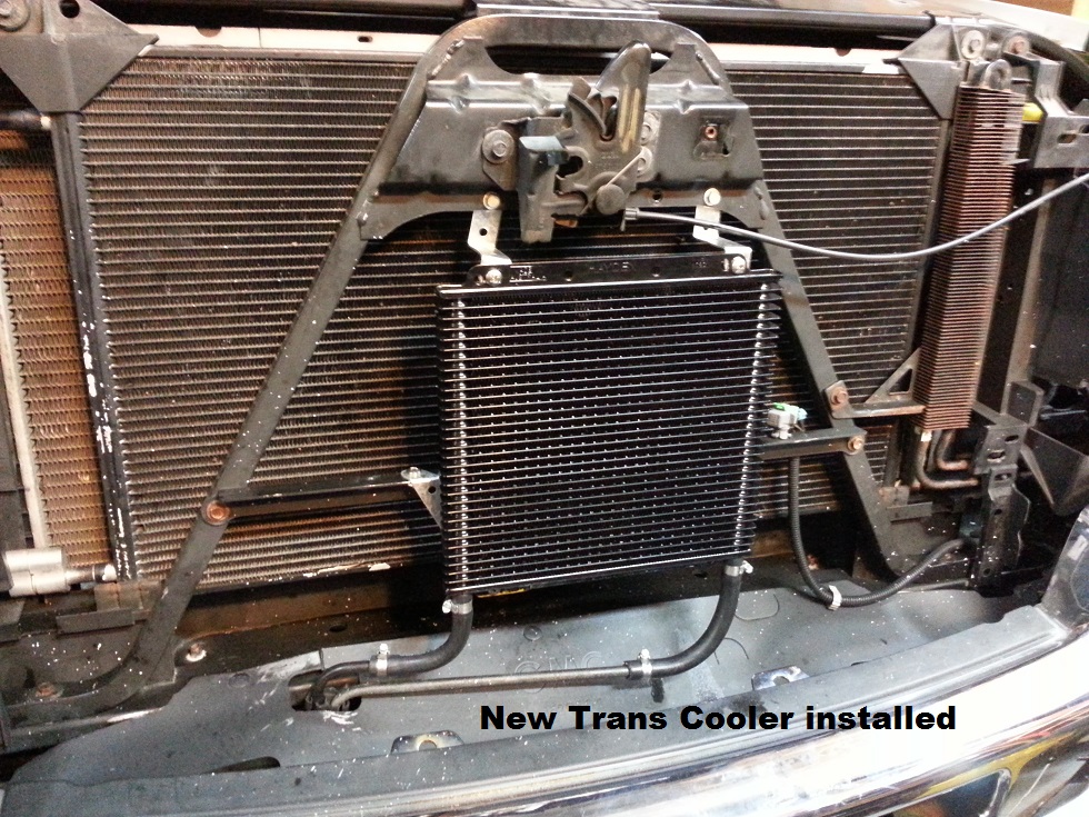

While its Drained, you "MAY" want to consider a Trans cooler UPGRADE. Its easy to pop out the headlights and grille and change it. Best to do it while fluid is drained.. about 50 dollars (USD) will get you a great B&M super cooler) Keeping the tranny under 200 will make it last and last.... The 4L80E was updated in 04, so keeping yours from heating will sure help a lot.

Pic of the trans cooler updatepost-142629-0-64627300-1479258764_thumb.jpgpost-142629-0-11648700-1479258793_thumb.jpg

Pic of the trans cooler updateattachicon.gifortranscooler.jpgattachicon.gifntc.jpg
