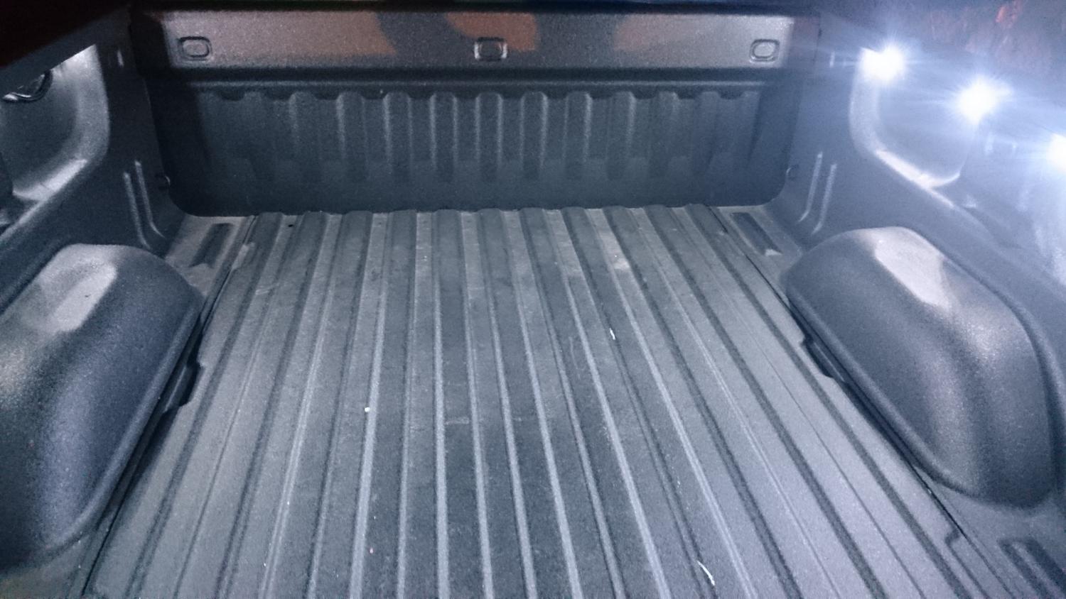

I got my LEDs for the bed from AutoZone for like $25. It has 8 LED pods, 4 for each side and I just tapped into the hitch plug wiring and mounted a switch in the bed. Eventually I'll tie them into the cargo light wiring so they come on with the overhead light too.

Look closely at my pic. Since I went with the strips and didn't want to cut them, you have to start then all the way forward. Kind of in the fender... Then over the wheel well, there is a bump out, if you go through there you have to pre feed it before peeling the tape. Just to save headache. Then the tail end goes into the fender again at the back by the tailgate. Just food for thought
