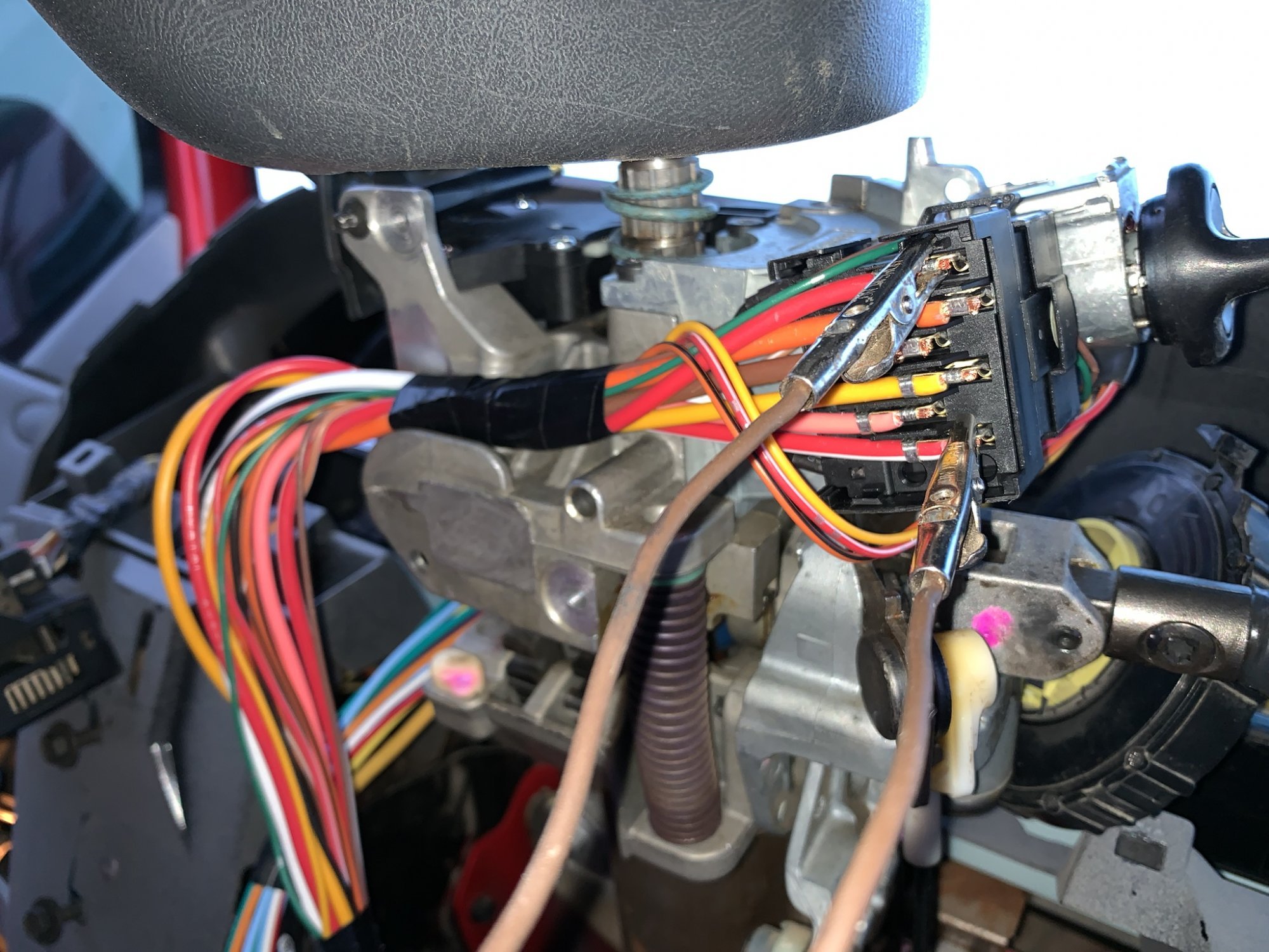

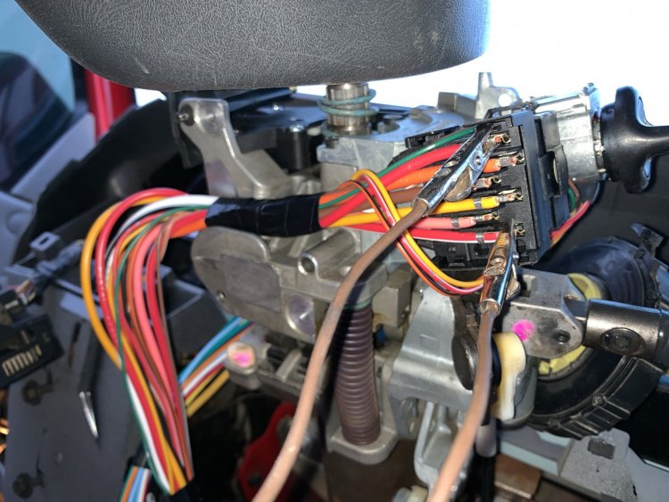

I have a similar no start/no crank issue on my 98 GMC Sierra k1500. The previous owner had resorted to a toggle switch/push button ignition due to several failing ignition switches. I removed that system and went back to stock system, replacing battery, ignition switch, ignition lock housing, key lock cylinder, neutral safety switch, checked all fuses & relays. Everything seems to work normal (all lights, fuel pump, dashboard, etc..) when key is in accessory or on positions. The only way it will crank normally, is if I jump between red - red/white at ignition switch. This indicates to me that there’s a connection not being made within the switch, right? This is my second new switch, just in case I got a bad one first time. Truck hasn’t moved! I’ve noticed there’s no key in ignition, door open or lights on chime and appears chime relay or whatever it’s called is missing from relay panel on fire wall near brake pedal. Would this affect the starting circuit? I am so stumped and getting sores on my head from scratching it. Please help!! ?
