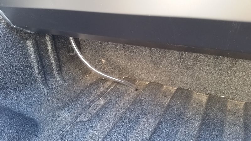

Here's my current drain tube set up I will probably end up drilling new holes out the back of the bed eventually.

Here it is I believe.  Or something very similar.  After going with it for awhile, I ended up just drilling out the other side hole to fit the tube as I found out that the brass adapter would get clogged with dirt or other debris and it would leak out from the gasket.    I almost drilled holes out the back of the bed towards the cab, so I could slide stuff all the way to the back but never did.
I'm interested to see how your cover does.  Mine is coming up on 3 yrs old and it's leaking from in between the panels and also from the drain tube gaskets.  Not too happy about that.
