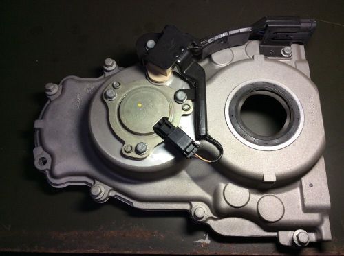

So this is my timing cover... VVT or NON VVT? I ordered a cam and all the parts for a non vvt engine!attachicon.gifIMG_4140.JPG
VVT.
